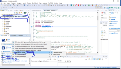

I have been experiencing difficulty stepping through interrupt handlers I have written for SPI, perhaps due to the limitations of Semihosting.  I am able to step through my interrupt handler once, but then after that my interrupt handler is mysteriously being called again even after I have disabled interrupts using the code
SPI_DisableInterrupts(SPI9, kSPI_TxLvlIrq | kSPI_RxLvlIrq );
From the MCUXpresso IDE User Guide I understand that there is a way to turn off the Semihosting, but I can’t find the method to do that.  I would like to place a counter in my interrupt handler, and after it has been called use a printf to display the number of times the handler has been called.  Will someone please tell me how to do that in the MCUXpresso IDE.
I am working with the LPC54018 development board OM4003.  I began with the project lpcxpresso54018_spi_interrupt_b2b_master but significantly modified it.

xiangjun_rong
Pls refer to the following screenshot to know the switch between Uart and semihost. The first step is to select the project.
Hope it can help you

It is not my intention to put the printf in the ISR handler.  I will put a counter variable in the ISR handler and have it printed in main.  But my question here is how do I tell MCUXpresso to avoid using semihosting so I can perform my testing, and then how do I restore the semihosting features after testing?
The following is copied from the MCUXpresso IDE User Guide:
When you have linked with the semihosting library, your application will no longer work standalone – it will only work when connected to the debugger. Semihosting operations cause the CPU to drop into “debug state”, which means that for the duration of the data transfer between the target and the host PC no code (including interrupts) will get executed on the target. Therefore, if your application uses interrupts, then it is normally advisable to avoid the use of semihosting whilst interrupts are active – and certainly within interrupt handlers themselves. If you still need to use printf, then you can retarget the bottom level of the C library to use an alternative communication channel, such as a UART or the Cortex-M CPU’s ITM channel.
6,159 Views
xiangjun_rong

This is what I was looking for, a way to switch between semihosting and UART modes without creating a new project.  This should be in the MCUXpresso IDE User Manual.  If it is, I didn't see it.  If there is any further documentation I have missed, please let me know.
