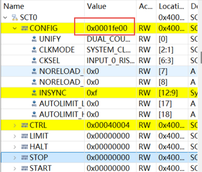

Hi, I use the lpc54628 and have a problem whit the SCTimer (INSYNC).
Table 334. UM10912 Rev. 2.4 11 November 2019
I use 5 Inputs and all 10 events rise/fall edge. On inputs 0 – 3 whit INSYNC Bit 0 - 3 = 1 everything works like it should. But Input 4 doesn’t work properly. Too use it properly I must set the corresponding INSYNC Bit4 (13 Bit in SCT CONFIG Register). But the UM says these bits are reserved, the IDE shows that only Config Register bits 12 - 9 are for INSYNC and the SDK code also sets only 4 bits.
Se here:
LPC54628.h the Mask for the INSYSNC.
#define SCT_CONFIG_INSYNC_MASK (0x1E00U)
#define SCT_CONFIG_INSYNC_SHIFT (9U)
And also, the function SCTIMER_GetDefaultConfig() set only 4 bit INSYNC.

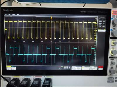

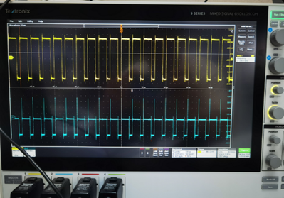

1.Yellow is the Input4 (1Hz 50%/50% frequency generator).
2. Blue is the output kSCTIMER_Out_9.
In Picture tek00004.png - tek00006.png the Bits 13 – 16 are off. The detection of the rising edge is unreliable.
I switch the Bit 13(channel 4) on, and it works correct as expected see tek00007.png.
The behavior for all bits 13-16 channel 4-7 is the same as 9-12 channel 0-3. When I set the corresponding bit 1 it works immediately like it should.
It is hard to believe that the INSYNC function is only for channel 0-3 when the SCTimer have 8 inputs. There is also nothing in the errata too SCTimer.

I have reproduced on my side. Yes, I think this is doc issue.
When refer to UM, do not set bit 13 to 1. Keep it to reserved.
Result as below :
While set bit 13 to 1,
Result as below:
I have reported it to related team. I will send to you with any update.

INSYNC in CONFIG register controls  Synchronization for input. Only the four inputs input0-input3 have this function.
- A 1 in one of these bits subjects the corresponding input to synchronization to the SCTimer/PWM clock.
- Clearing this bit bypasses synchronization on the corresponding input. This means disable synchronization function. but input function still works.
There is no this Synchronization function with Input4.  So it has no effect on input4 if setting 13 Bit in SCT CONFIG Register.
