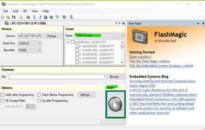

3L1S4_
Hi Pavel,
thanks for your quick reply.
We generally use this software (to write firmware) FLASH MAGIC.
Do you know it? Is the procedure to erase all memory the same?
Thanks so much,
Best Regard
1,445 Views
Pavel_Hernandez
Hello, I do not use the flash magic before, but I download it, could you try to select on the erase section entire device?
And then start. Let me know if this help you.

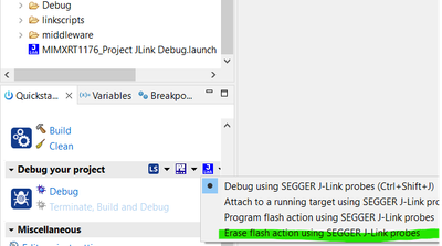

Pavel_Hernandez
Hello, my name is Pavel, and I will be supporting your case, there are two ways to do a mass erase, you could use the IDE with your debugger probe.
Look at the image use it at example, just need to know what kind of debugger you have.
The other way if you do not have the debugger maybe you could use the Uart and use the ISP mode on the MCU, then use the BLHOST to send a come for erase all memory.
Pavel
