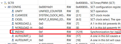

I use 5 Inputs and all 10 events rise/fall edge. On inputs 0 – 3 whit INSYNC Bit 0 - 3 = 1 everything works like it should. But Input 4 doesn’t work properly. Too use it properly I must set the corresponding INSYNC Bit4 (13 Bit in SCT CONFIG Register). But the UM says these bits are reserved, the IDE shows that only Config Register bits 12 - 9 are for INSYNC and the SDK code also sets only 4 bits.
Se here:
LPC54628.h the Mask for the INSYSNC.
#define SCT_CONFIG_INSYNC_MASK (0x1E00U)
#define SCT_CONFIG_INSYNC_SHIFT (9U)
And also, the function SCTIMER_GetDefaultConfig() set only 4 bit INSYNC.

Course when I set the 4 bit in INSYNC by debugger, apparently everything works like it should.
Is there an error in the documentation and SDK, or is there a something wrong in the Config Register bits 16 - 13 INSYNC (Bits 7-4) and we should not use them?

Hello @A_M
INSYNC in CONFIG register controls  Synchronization for input. Only the four inputs input0-input3 have this function.
- A 1 in one of these bits subjects the corresponding input to synchronization to the SCTimer/PWM clock.
- Clearing this bit bypasses synchronization on the corresponding input. This means disable synchronization function. but input function still works.
There is no this Synchronization function with Input4.  So it has no effect on input4 if setting 13 Bit in SCT CONFIG Register.
