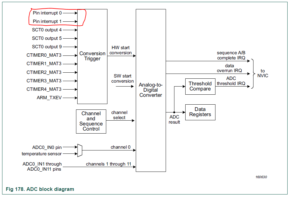

Hi, I am working on this with George. When this ADC issue occurs, PIN_INT0_DriverIRQHandler(void) and PIN_INT1_DriverIRQHandler(void) are still being called. The issue is that the conversions never starts and so ADC0_SEQB_IRQHandler(void) and ADC0_SEQA_IRQHandler(void) never get called. I modified the pin interrupt handler to call the adc handlers where we read the data but of course the data never changes because the conversions do not start. Do you know how the link between the pin interrupt and the start of the conversion could be broken without any changes to the ADC or PINT registers?

According to your configuration you are currently using Group GPIO interrupt to initialize the conversion of the ADC for both sequences:
adcConvSeqConfigStruct.triggerMask = 1U;
adcConvSeqConfigStruct.triggerMask = 2U;
Could you please share with me how are you setting/configuring this group interrupts?

victorjimenez
Hello George Chancellor,
With the following statements:

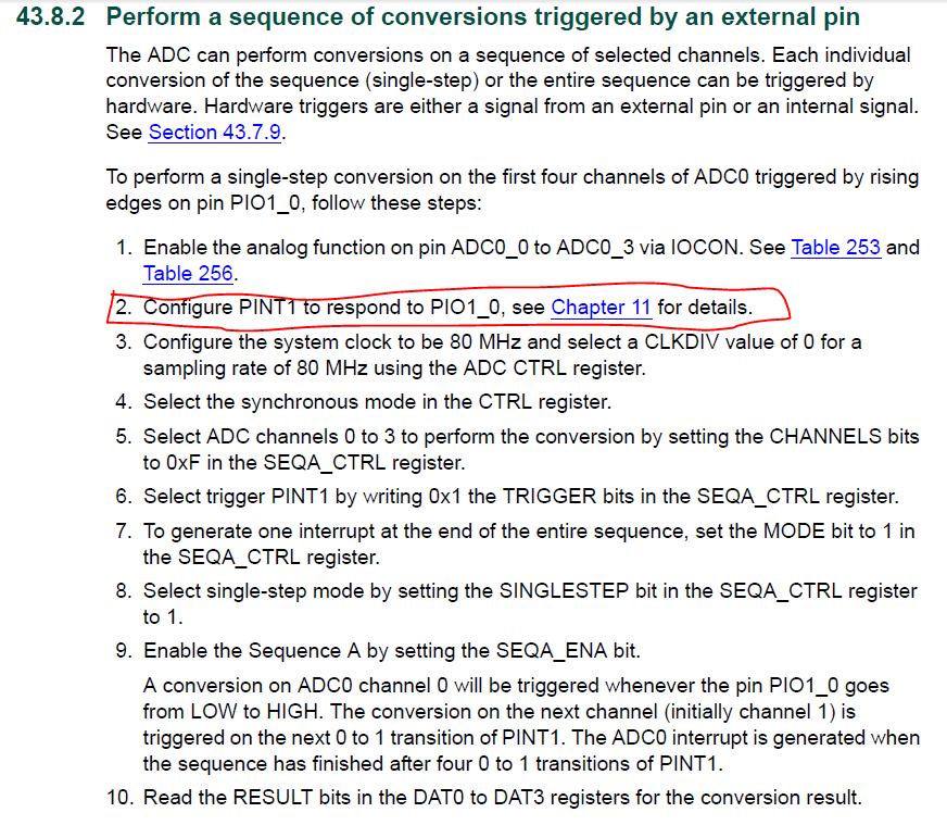

You are setting the Group GPIO interrupt to trigger the conversion of the ADC for both sequences (see image attached in my first reply). However, in the code you attached  you are setting Pin Interrupt instead of Group GPIO interrupt, these are two completely different things. You can refer chapter 14 of the User Manual to learn more about the Group GPIO interrupt. Also, in the SDK you can find an example on how to configure and run these interrupts.
Also, you have to be sure that you are clearing the interrupt once you are in the handler of the corresponding Group GPIO interrupt.

Looking at the manual the only reference in the ADC chapter of group interrupt is in the table you mentioned, but else were it mentions pin interrupts.
Then in the example section (43.8.2) it says to use PINT1 as the external trigger and references you to chapter 11 (Pin interrupt and pattern match (PINT)
The final thing I tried was having both the PINT and group interrupts enabled, and this still did not work.
