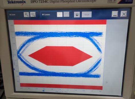

I try to use LPC546xx High speed USB1 port to connect with Lenovo T420 by ISP mode. That have chance to fail ( unknow device ). Our LPC546xx's USB1 is pass eye diagram.
The following is LPC546xx USB1 eye diagram test.

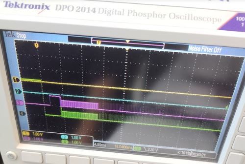

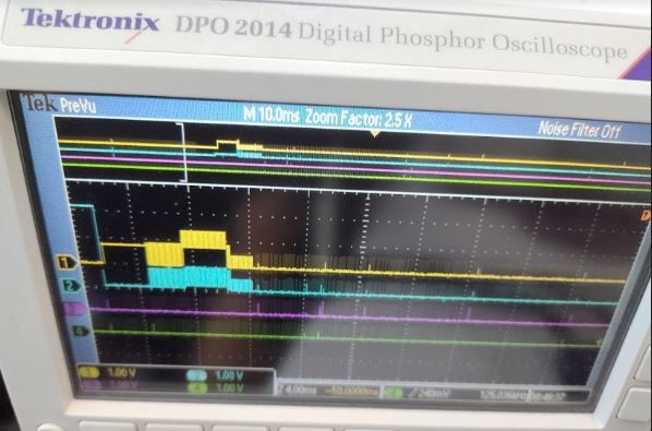

I found LPC546xx USB1's high speed detect handshake have some abnormal waveform.
The following is LPC546xx  high speed detect handshake waveform. ( Blue is D+, Yellow is D- )
lpc546.JPG This is fail waveform.
lpc546_fail.JPGThis is retry to success detect
The following is High speed USB 2.0 mass storage with USB cable. ( Green is D+. Purple is D- )
