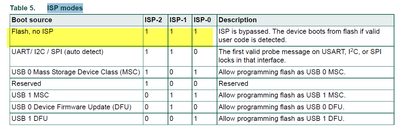

We have confirmed the crash / freeze problem is:
  • The SDRAM when operating, and when the hardware or software reset becomes active while the SDRAM is grabbing the data bus / outputting data, that data WILL STAY ON THE DATA BUS and the ISP pins send your system searching for good code to load. The variable data output by the SDRAM and the possible disabled outputs during normal operation cause the intermittent errors. SOLUTION: Only killing power to the SDRAM prior to or at the beginning of RESET, or clocking through any command that removes the output from the bus will work. Changing the logic state of an SDRAM synchronous disable pin will not work unless clocked through.
  • The bootloader code succeeds or then crashes / stalls / faults / gets stuck and requires a power cycle OFF-ON to recover.
  • Not the pullups.  The internal pullups work fine.  External pullups as low as 2.2k seem to leave plenty of margin for logic levels and speed.  YMMV.  Please test it yourself.

Yes, we've got an SDRAM hooked up to the EMC pins in exactly the same configuration as the NXP dev card.  We're aware that the EMC D2, D3 and D4 share function with ISP0, ISP1 and ISP2.  We connect the debugger ISP pins via 2K2 resistors as per the dev card schematic.  We see the processor intermittently hanging during reboot with and without the debugger connected.
We are wondering if the fact that the processor always stalls at 0x30012C2  when it fails to reboot might be a clue.  Note that when the processor stalls on reboot it requires a power cycle to recover.  On the other hand, if we reboot the processor into a valid ISP mode by manually holding the relevant combination of ISP pins low then it always responds to the reset pin and does not require a power cycle.  Perhaps this is another clue?

belmontbob59
NXP "boots" into auto mode (i.e. scanning all individual inputs (SPI, UART etc..) for a valid image. it sounds to me like you might need external  pullups on these ISP pins to guaranty autoboot mode upon MCU reset. Did you put a scope on these ISP pins to determine there state upon reset ?
However I don't know enough about EMC to determine if adding external pullups are going to  interfere with you SDRAM.

The solution is to use your nReset signal to the LPC54628 to control power to the SDRAM.  You can use a load switch or a couple of mosfets to switch off power to the SDRAM during reset.  With this solution you can maintain the pullups at 2k2 as in the dev card reference design.
