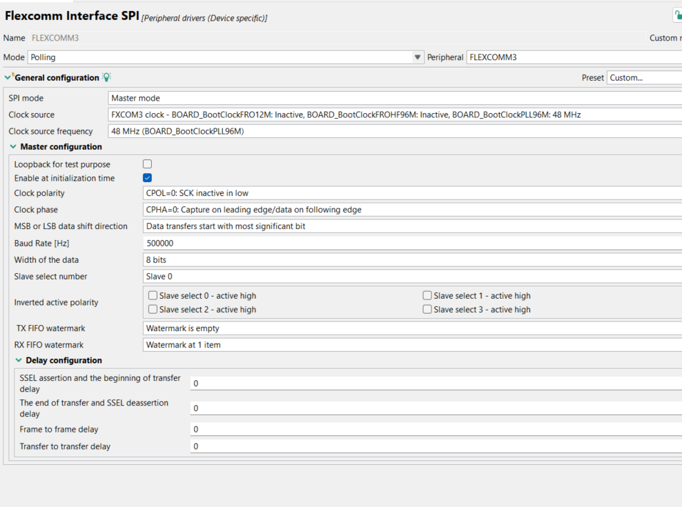

I am using LPC55S06 to communicate with another microcontroller by using SPI. My microcontroller is the master, the other one is the slave. The configuration is CPOL=0 and CPHA=0, and the datarate is 500kbps. The protocol is 2 byte of register address (with 1 bit that indicate read/write) and 4 byte of data.
When I write a register no problem on my way: the data sniffed with a logic analyzer is perfect, and the slave read data well. When I try to read a register, the slave send out the data, on the logic analyzer the data is perfect, but on microcontroller the last bit will be lost.
In example, if the data that I see on logic analyzer is 0x00000064, on micro I read 0x00000032, and so on. The code that read  is the following:

Where is the error? I can't see!

Hi, I found the problem: the slave device, an FPGA programmed by ourself, generate a wrong MISO message... so the microcontroller can't read well the data.
