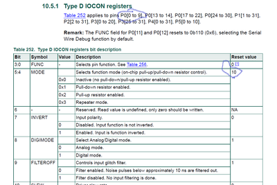

xiangjun_rong
After Reset, the ISP pins (PIO0_4, PIO0_5, PIO0_6)  on-chip pull-up resistors are enabled in default, so all the three pins are high, the cpu samples the three pins and get all high logic and start executing code from on-chip flash if valid user code is detected in on-chip flash.
Because the SDRAM data pins (EMC_D[2], EMC_D[3], EMC_D[4]) are connected to the above pins, it is possible that the SDRAM data pins (EMC_D[2], EMC_D[3], EMC_D[4]) maybe drive the the ISP pins during/after Reset, which leads to the fact that CPU gets a random value after sampling the above three pins. If you connect the EMC_DYCS pin of SDRAM to an external pull-up resistor, I suppose the SDRAM data pins (EMC_D[2], EMC_D[3], EMC_D[4])  will be float, in the case, the ISP pins (PIO0_4, PIO0_5, PIO0_6) will be high when cpu samples them, because of on-chip pull-up resistor.
