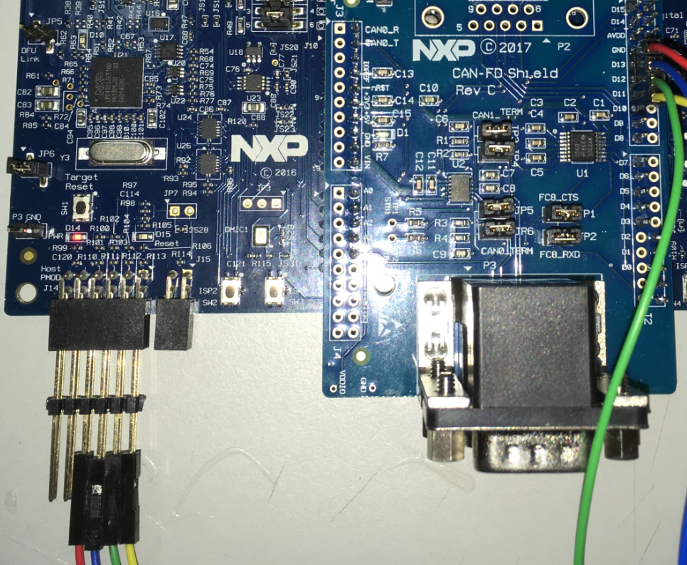

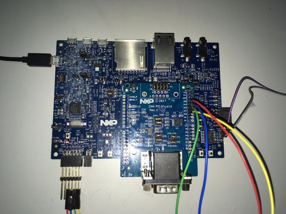

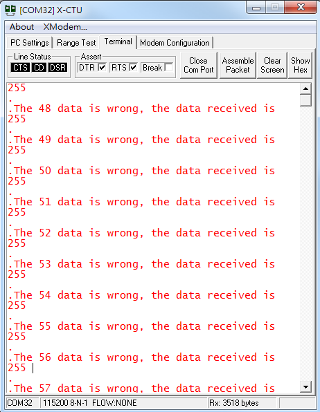

I downloaded the SPI interrupt example code of SDK_2.2_LPCXpresso54618 to my LPC54618 CAN FD Kit and i did not make any changes code,but SPI slave always received error.I connects  to J14-1.2.3.4
and i read the spi interrupt "readme.txt" file,Is the example SPI Master PIN correct?because i connects  to J9-PIN10.11.12.13 have SPI Master Data(0~63).But connects  to J9-PIN9.11.13.15 have nothing
This is my way of connecting the entity

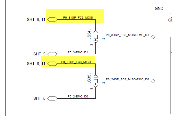

Hi Cheng yo huang,
   This code is working in revB, but LPCXpress54618 rev C need to take care JS34, JS35, you need to modify the board connect, you need solder it in the correct position.
Besides, you need to connect JP6.

2,645 Views
kerryzhou
Hi Cheng yo huang,
   Please remove the CAN FD board, check the LPCXpresso 54618 board version, what the version you are using?
