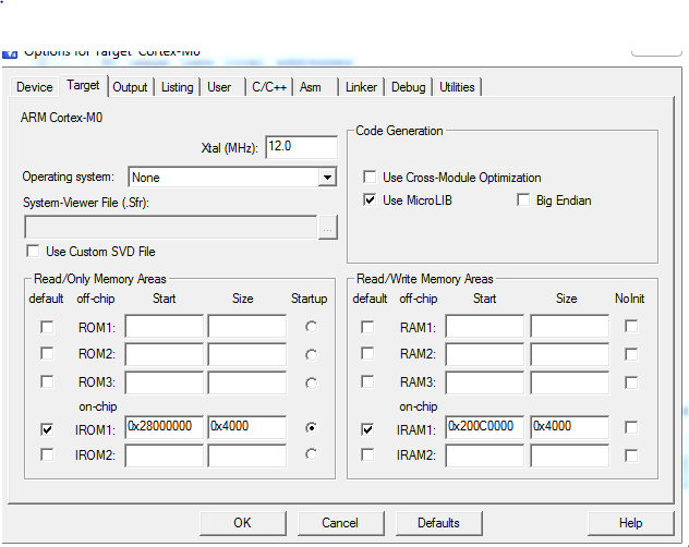

Hullo Guys , I'm developing code for the LPC4357 dual-core MCU . Im using KEIL IDE . I managed to create separate codes for each core . The problem is that when I execute the Cortex-M0 code from Flash Bank B (pointed to by the M0APPMEMMAP shadow register ) it works as it should . But when I try run the code from anywhere else , whether internal SRAM or external SDRAM (also pointed to by M0APPMEMMAP) , by copying the generated image file from the M0 project into that SRAM/SDRAM location , its not working ??? .
In KEIL , I set the Target options for the M0 project properly , thus the generated linker script points to the correct memory areas IRAM and IROM .
So far I think its linking problem such that I do not seem to remap the Vector table properly.
This is the settings of the M0 Memory areas .
Any ideas ? ????#

muhammadt
Thx for ur answer Jeremy , but that does not answer the qs at all .
