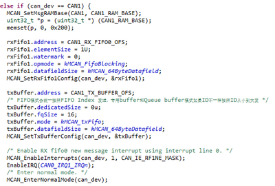

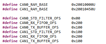

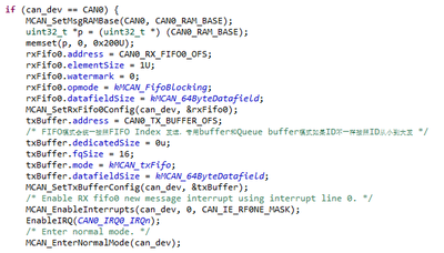

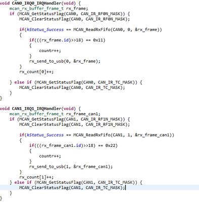

When two CANFD interfaces of LPC54616 chip are used, when there are a lot of CAN bus messages, CAN read messages with ID of 0 will appear (but there are no actual messages in the bus, it is speculated that rxfifo, massage ram overlap? Or failed to read?) The following is the massgeram of the two CAN interfaces that I configured. I used rxfifo in interrupt to read the message. Now I hope the kind people CAN provide a configuration method in which two CAN/CANFD messages do not make mistakes. If I want can1 to use rxfifo1, and the massageram of the two routes do not overlap, what should I do to configure the message without error
