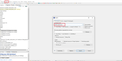

On the LPC54628 dev. board I am trying to combine LWIP with LVGL to create an app with graphics and Ethernet ability.  I started with the LWIP demo and added the necessary code to implement the touch panel functions.  The issue I am having is that the panel polling function "DEMO_ReadTouch(...)" is not being called.  On the original LVLG demo the "DEMO_ReadTouch(...)" function gets called every 100 uS.  The "DEMO_InitTouch(void)" function does send 3 bytes of data over the I2C lines so I know the hardware is working.  Just above the "DEMO_ReadTouch(...)" function is the line /* Will be called by the library to read the touchpad */  but I don't know where the calling function is to see why it isn't firing.
Does MCUXpresso have a way to see where a function was called from?

Hi @samv
You can search it in the project.
Harry

I discovered that the lv_task_handler() was not called in the main startup routine. Once I corrected that it is now working fine.
