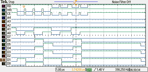

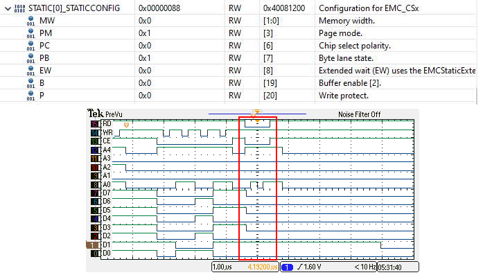

We are using the LPC54616 with an SRAM device and an FPGA on the memory bus.
The EMC is being operated with burst mode disabled, so would expect multi-byte access to the external memory to be performed on individual read/write operation. This appears to be the case for write accesses, but not for reading, see image below...
LPC54616 Multi-byte Write/Read (Burst Disabled)LPC54616 Multi-byte Write/Read (Burst Disabled)
 Single byte reads/writes operate as expected. All accesses to the FPGA are with single byte accesses.

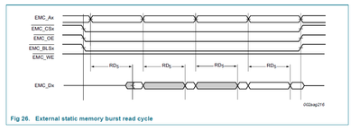

The datasheet (LPC546XX Rev 2.6) shows an example of a burst read cycle, which is what we are seeing. No example is provided for multi-byte access in non-burst mode.
LPC54XXX DataSheet Rev 2.6LPC54XXX DataSheet Rev 2.6

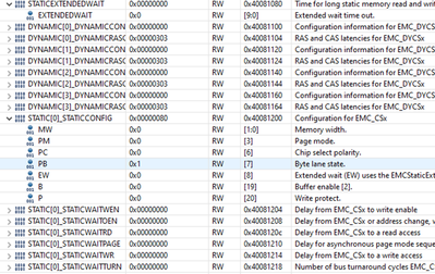

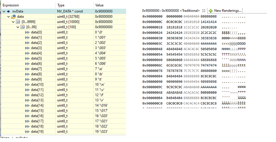

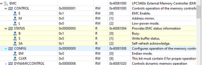

Using MCUxpresso, examining the same external memory in the Expression and Memory windows gives different results. The representations below are of the same base memory location at the same moment in time. It is assumed that the Expression window (Left-hand image) is extracting each byte individually whereas the Memory window (Right-hand image) is reading four bytes at a time.
The controller registers shown below are following configuration of the EMC peripheral
  • Bus Width (MW) = 8 bits
  • Page Mode (PM) = Disabled
  • Burst Control (EMCBC) = Disabled
  • Buffer (B) = Disabled
Are there any further configuration parameters that need to be set?
Could anyone confirm/clarify the operation of the EMC with the burst mode enabled and disabled?

I think you have disabled  the static memory burst mode with the STATICCONFIG0[PM]=0, with the current reading/writing, do you have any issue? for example reading data is wrong. I suppose that the reading data are okay.
For the timing circled with blur frame, the A0 address toggles at the early stage, I think the data is latched to the MCU at the rising edge of Rd or CS, the toggling A0 does not take effect on the data latch.
I suppose that you can set the delay register for example
EMCStaticWaitRd0=10;
EMCStaticWaitOen0=3;
EMCStaticWaitWr0=10;
Pls have a try.

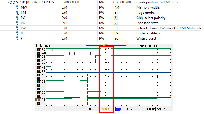

Setting/clearing the STATICCONFIG0[PM] bit had no effect on the reading of data. In both cases, see below, the read operation failed.
Page Mode - DisabledPage Mode - Disabled
Page Mode - EnabledPage Mode - Enabled
Adjusting the delay registers (EMCStaticWaitRd, EMCStaticWaitOen, EMCStaticWaitWr, EMCStaticWaitOen) again did not affect the outcome, the read operation failed.
  • Writing single byte is Ok
  • Reading single byte is Ok
  • Writing multi-byte is Ok
  • Reading multi-byte fails.

The SRAM device being used latches the address on the later falling edge of either of the CE/WR or CE/RD signals depending on the operation being performed. At the moment for reading there is only a single read cycle (CE/RD) being generated for multi-byte access.
If it is not possible to configure the micro to generate read signals equivalent to how the write operation is currently performed, then the only way forward would be to modify the software to perform accesses to multi-byte SRAM variables a byte at a time.

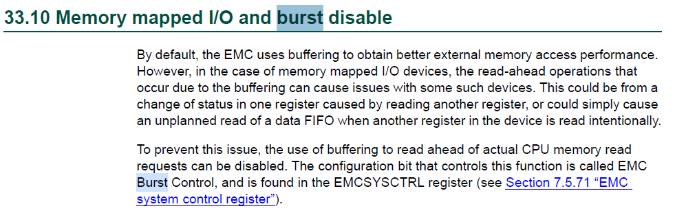

Reading the documentation (User Manual and Datasheet), particular Section 33.10 of the User Manual seems to indicate that running the micro with burst disabled would be the solution, but it appears not to have any effect.

There were 2 write (WR) cycles for the 16-bit access, and 4 four write (WR) cycles for the 32-bit access. In both cases for reading there was a single read (RD) cycle, with the address bus changing during the read cycle.
Do you have any example waveforms (along with example code) showing the difference in operation of the EMC with burst mode enabled and with it disabled. Or any examples showing a multi-byte read operation being performed over multiple read (RD) cycles. It may be that the micro cannot be configured this way
At the moment it appears the micro is relying solely on the data bus being updated in response to a change on the address bus, whereas the SRAM device is latching the address on a falling edge of CE/RD.
Below is an example of our previous controller (ST10) performing a similar test (i.e. writing/reading a 32-bit value). As you can see for the read operation both the CE and RD lines are being activated multiple times during the read. Is this achievable on the LPC54616?ST10 Write/ReadST10 Write/Read

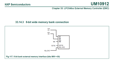

There is timing of burst reading in data sheet of LPC546xx, I attach the data sheet of LPC546xx, pls check 11.5 External memory interface.
BTW, do you use Byte SRAM and connect the Byte SRAM like the following pic?
Yes I've checked this burst reading waveform (see my original message). Is there a corresponding waveform example with burst read disabled?
Yes the data bus is 8-bits wide, and the signal connections are as in the diagram 33.14.3 8-bit wide memory bank connection that is shown.
