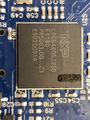

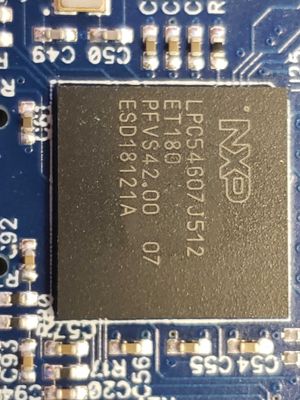

guitardenver
Alice,
Here are two images. Each MCU has the issue.

corytodd
Hi Alice,
All parts are from official distributors, from a wide range of datecodes/lots.
Here is a picture of one that is working.
On working chip, jlink unlock works say "successful, power cycle the mcu"
On a locked out chip, jlink unlock says "unlock failed".

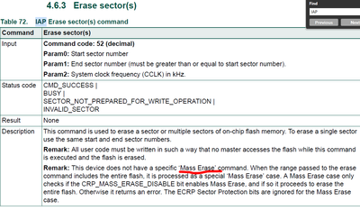

We tried using the IAP command EraseSector to do a "Mass Erase" as describe below:
 But this did not recover SWD access either. Which means our bootloader is now erased and the MCU is completely bricked.
