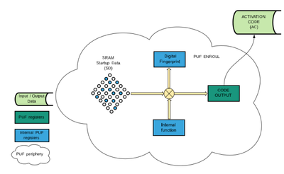

I am kind of new to the PUF consept. I am using the drivers>PUF example with LPC55S69.I have 3 questions. First, If I use the same activation code after the enroll to start the PUF means that I would have same SRAM cells values. Secondly, how do I get the same intrinsic key to use after I restart the device?. What is the actual meaning of keycode?
->> Yes.
->> About these question, recommend you have a look at the AN12324
https://www.nxp.com.cn/docs/en/application-note/AN12324.pdf

Is there any way to have direct access and read fingerprint? Furthermore, do I have knowledge of Internal functions or am I able to change them?
3,006 Views
Hello satsok_n,
NO.
