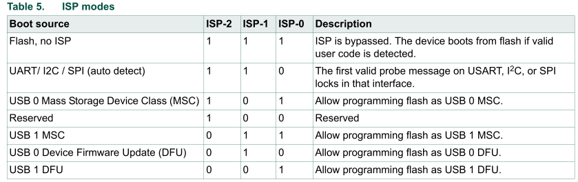

I have a question about LPC54608 USB DFU.
Could you know how to get the example code of LPC54608 USB DFU.
Because I see the below picture( UM10912.pdf )
LPC54608 can support USB DFU, but I can't find any example code for reference, could you give some suggestion to us how to implement it?
