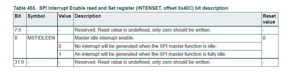

2. How do i get an interrupt on Master Idle? I have enabled INTENSET, and i was expecting to receive an interrupt on FLEXCOMM3_IrqHandler. But i don't get an interrupt. Do i need to enable any other flags?
  Please check the user manual at first:
I think you can STAT[MSTIDLE] bit directly instead of using the interrupt.

On MSTIDLE - i understand the STAT part, but as i indicated in my question, the IDLE bit never seems to be going high even though there is no activity on the SPI. SPI is being configured as master.

Also - the SPI module MSTIDLE bit never turns on in the status register. There is no activity on the SPI, and should be idle.
