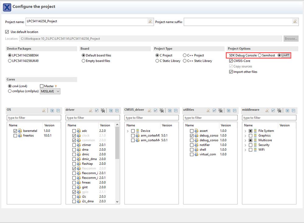

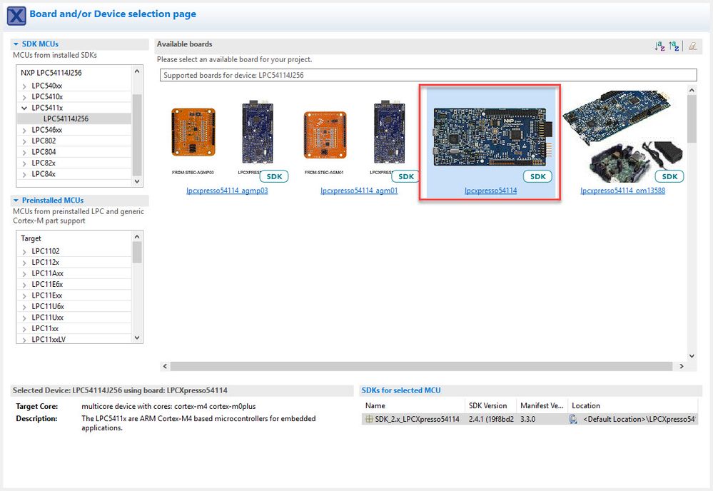

Hello Dineshkumar J,
Unfortunately, I'm not able to reproduce the behavior you mentioned. Here are the steps I'm following to create the new project.
Select New project in the Quickstart Panel
Select your development board, in this case LPCXpresso 54114.
 Select UART as the SDK debug console.
Leave default properties in Advanced project settings and click on finish.
When I enter to the debug session I'm able to see the Hello World printed in the terminal. If I exit the debug session and I reset the board I'm also able to see the Hello World in the terminal, so the project is still there once I exit the debug session.
Could you please follow these steps and try with a simple project that just prints Hello World in the terminal?
Hope it helps!
Victor.

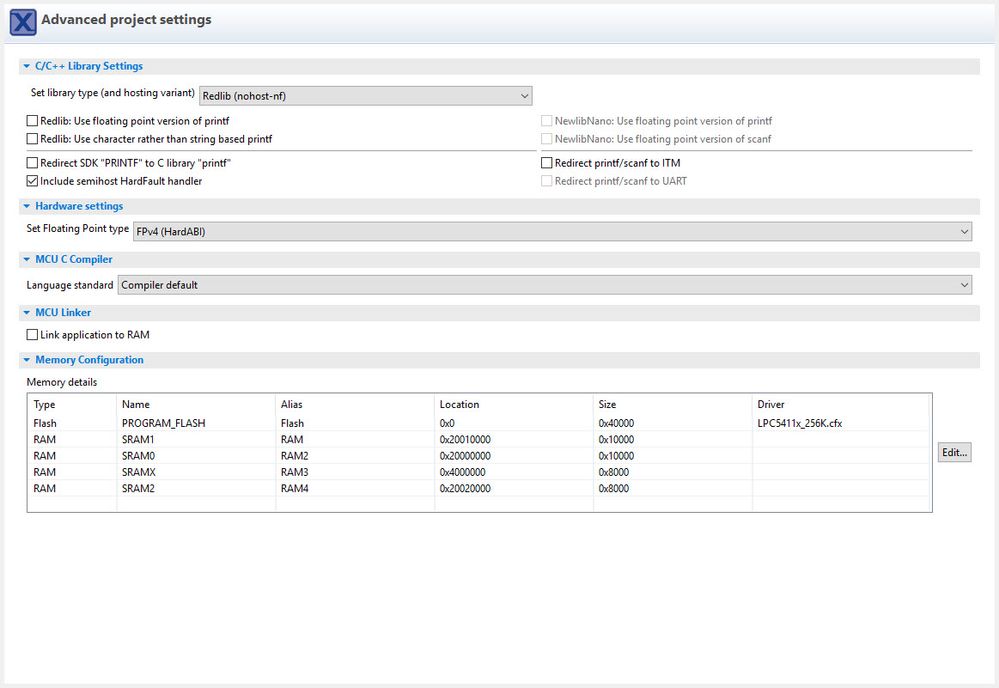

converse
Senior Contributor V
Are you using printf to the console? If so, that only works when debugging - otherwise it will hang, waiting for the debugger.
6,461件の閲覧回数
Dineshkumar_J
I don't think it could be the problem because printf command also used in the example codes but it still working after the debug closed.
6,461件の閲覧回数
converse
Your project is probably configured semihosting printf : See section 15.4, "What is Semihosting?" (and in particular section 15.4.5,"Semihosted printf and Debugging"), of the MCUXpresso IDE v10.2.0 User Guide for details.
Either ensure that you have the hard fault handler in your project, or else you can probably use Quick Settings to reconfigure the PRINTF macro to point to the UART DEBUG_CONSOLE system (see section 18.1, "Quick Settings" for details).
6,461件の閲覧回数
Dineshkumar_J
Now I removed all PRINTF lines from my code but the problem still occurs. It runs in debug mode but not in normal mode.

Dineshkumar_J
Hi victorjimenez,
I tried your solution it works great.
The problem is when I use this settings with my coding it produce the same problem. So that I debugged the entire coding step by step. Then I figured out the real problem. My coding is entirely based on the current time based switching condition. For getting current time I used the clock() function described in the time library. This returns the correct value in the debug mode. But not in the running mode. To confirm this I unindent the clock function write the simple blinking condition based on input it works fine, and also I created a new project to print the clock() functions return value. It output is strange not like the expected one.
