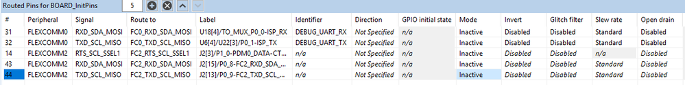

I've been working at getting the RTS pin on the LPC54114 to serve as hardware flow control for the RS485 driver's output enable (henceforth referred to as OE) and receiver enable (RE) pins. On the module, the OE and RE are tied together so that when you pull it HIGH, the transmitter is enabled, and when LOW the receiver is enable.
Despite my best efforts, I have not been able to get the flexcomm driver to handle this automatically and have had to resort to a function that wraps around the USART_WriteBlocking and uses GPIO to manually pull the RTS pin high before any send and then bring it back low once done.
I tried directly changing the OESEL and OEPOL bits by calling lots of variations of the below code either directly after the RESET_PeripheralReset call and after the USART_Init call in peripheral.c
USART2->CFG |= (1 << 20);‍
USART2->CFG |= (1 << 21);‍‍‍‍

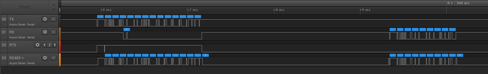

Successful send and receive when using GPIO to toggle RTS

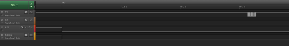

Failed send and receive when using above bit flags, RTS is not pulled high for output enable
Pin tool routing
Peripherals tool config

So, consider this solved, it was a matter of placing the bit flags for the OESEL and OEPOL configuration after the USART_Init method and not before.
Turns out the USART_Init method sets the whole CFG register and not just the flags it's concerned with (=  vs |=), so I moved the
USART2->CFG |= (1 << 20) | (1 << 21);‍‍
to just after the USART_Init and it works now.
