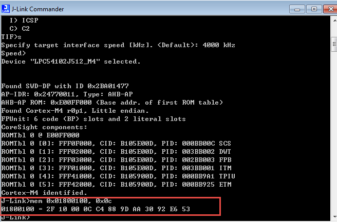

kerryzhou
Hello Ratheesh T,
   1. 54102 has Unique ID (UID) or not ?
Yes, LPC54102 have the UID, each chip have different UID number.
  2. What is the use of above two section of Read UID for my use? or it has other UID for my usage?
IAP and ISP read UID is just two different ways to get the chip UID. ISP can use the ISP, take an example, UART, and associate with the flash magic software(read device signature) to get the UID. IAP is the command you can used it in the code. Actually, UID is the same, just read method different.
 But, please take care, in lpc54102, the errata has some description about it:
http://www.nxp.com/documents/errata_sheet/ES_LPC5410X.pdf
So, just like the workaround, pleas read the flash address directly.
Take an example, I use the JLINK commander to read these bytes:
You also can try it like this, I also use teh LPCXpresso54102 revA, OM13077.
Wish it helps you!
If you still have question, please let me know!
Kerry

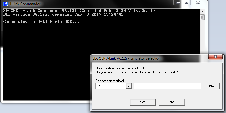

ratheesht
Hi Kerry,,
I have installed J-link612 software in my PC (WINDOWS 7 OS) and connected the LPC54102 board
When i open the J-link-commander, it shows the following error
there is no name or ip related to lpc54102 in  connection method tap. .
What i have to change to make this as work?
5,100 Views
brendonslade
Have you flashed your board with the J-link firmware, and repowered the board to boot with that firmware (remove the DFU jumper)? Use LPCScrypt to do that (nxp.com/lpcscrypt). J-link firmware is not installed by default (CMSIS-DAP) is.
BTW, you don't have to use J-link to use the ID. Kerry is just showing you a way to leverage the Segger software to easily see the ID. Another way to do that is to use the free Flash Magic tool (www.flashmagictool.com).
5,100 Views

kerryzhou
Hello Ratheesh T,
   Flash Magic is using the ISP, just as I told you, ISP to read the UID have bug.
   About the JLINK commander problem, you must use your board is using the JLINK firmware at first.
