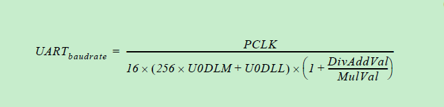

   From the UART baud rate calculate formula:
1. 1 <=MULVAL  <= 15
2. 0 <= DIVADDVAL <=14
3. DIVADDVAL< MULVAL
We can get all the factors which may relate to the UART baud rate.
Normally, the baud rate allowed error is +-1.5%, the lpc1313 defined should less than 1.1%.

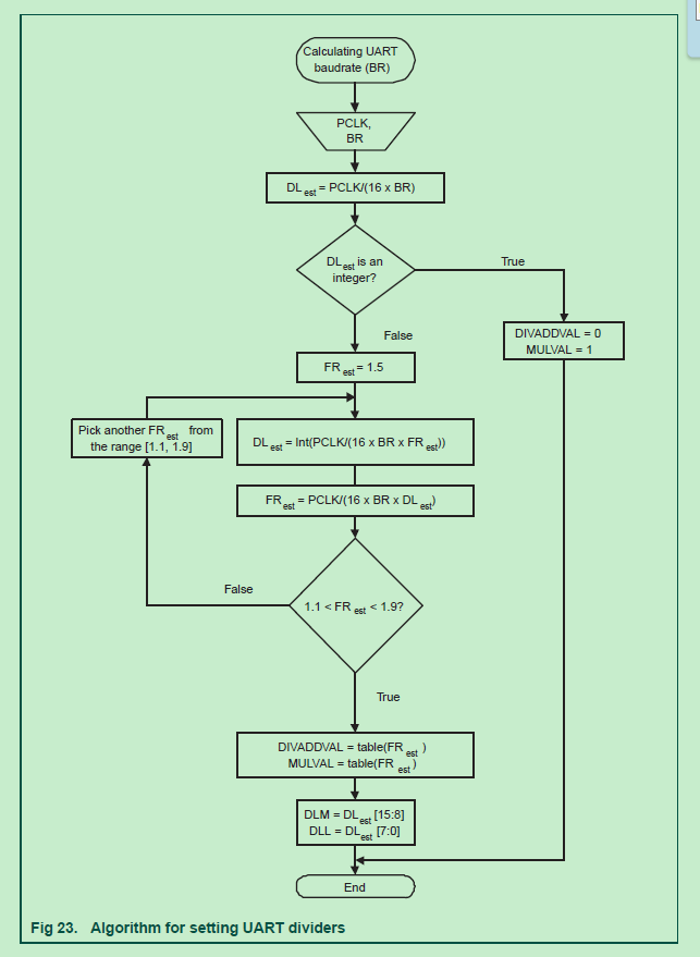

So, you need to follow this flow to calculate the according data:
If in the fixed PCLK, all the other parameter can't meet your demand, you need to consider to choose the other PCLK(clock), then calculate it again.

Take your system clock 72Mhz directly as the uart pclk, just follow the algorithm for setting USART dividers which I give you before.
1. Dlest= 72Mhz/(16*921600)=4.88.
   It is not the integer number, so the next step is to estimate the FR parameter.

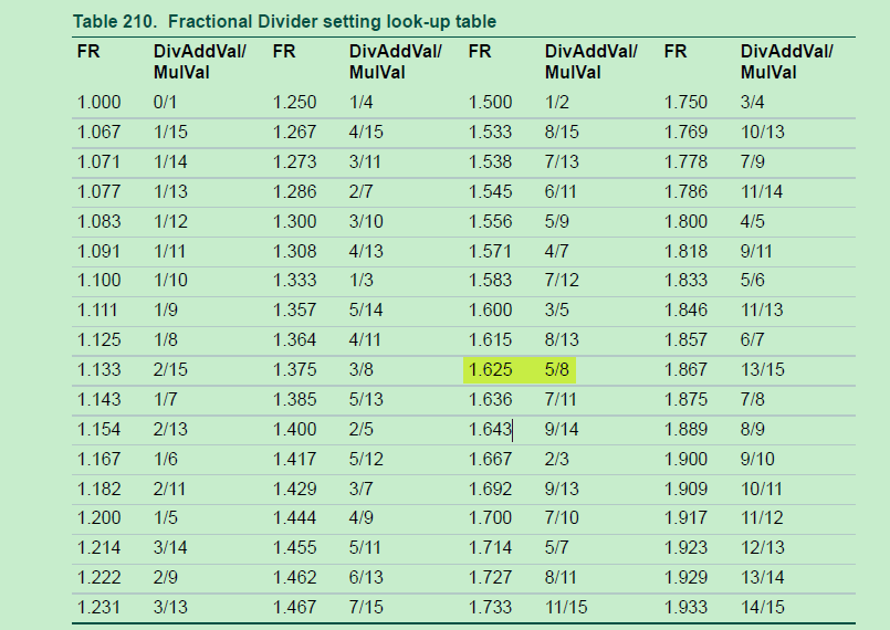

2. Using an initial estimate of FRest=1.5.
  Dlest_new=72Mhz/(16*921600*1.5)=3.2, take the integer data 3 as the DLest data.
  FRest=72Mhz/(16*921600*3)=1.627, it is in the range of 1.1 and 1.9.
Checking the table, choose the closest value for FRest=1.628, it is .625.
so, at last, the DIVADDVAL=5, MULVAL=8, DLM=0, DLL=3.
Now, use these value, to calculate the real baudrate it will get:
baudrate=72Mhz/(16*(256*0+3)*(1+5/8))=923076 bps.
The relative error is (923076 -921600)*100%/921600 = 0.16%, it is smaller than 1.5%.
So, you can get 921600 with the data which I calculated.
