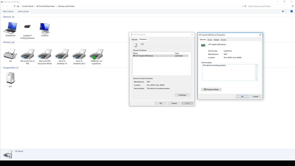

- The board is recognized as shown in the image below

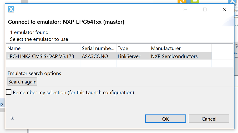

- JP5 is shunted to use Relink protocol
- USB is connected to J6 (I tried in both USB3.0 and USB2.0 ports)
- The emulator is found.

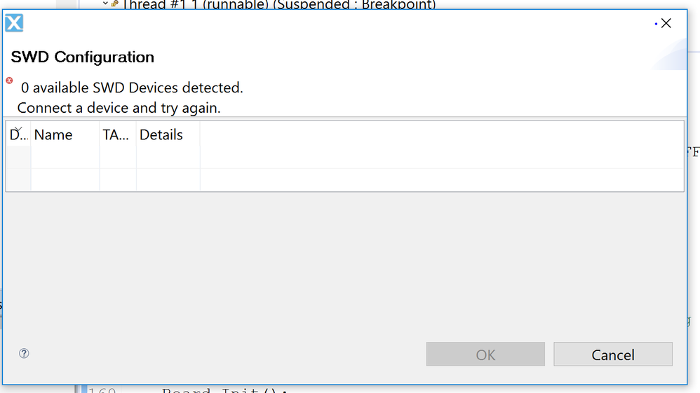

1. I build both lpc_board_lpcxpresso_54102 and lpc_chip_5410x projects.
2. I build multicore_m4master_blinky project
3. I debug multicore_m4master_blinky project. Debugging shows no erros. Execution stops at line 156 ("int loop = 1; /* Fixes unreachable statement warning */") Note: No SWD configuration window appears, I don't select Cortex M4 as the device.
4. I resume to the breakpoint set at line 207 ("Chip_CPU_CM0Boot(jumpAddr, stackAddr);")
5. I try to build multicore_m0slave_blinky
6. SWD Configuration window appears where no devices are detected.
Sometimes I also get the "No source available for "0x30002da" error.

Is that the entire Redlink Server log? It doesn't look like the IDE has attempted to open a debug connection. Is there anything in the Debug, or gdb-traces logs? Have you ever downloaded an application with a Code Read Protection (CRP) setting?

This is the same issue as your previous post from the look of things. The LPC device you see means the CMSIS-DAP probe has not booted. If you jumped JP5, it allows the IDE to DFU the latest probe firmware. If, instead, you wish to boot a probe from flash (JP5 not connected) you'll have to use a tool like LPCScrypt to flash the probe image. Here's a link to that tool:
LPCSCRYPT:LPCScrypt v1.8.0
Unfortunately, LPCScrypt hasn't been released recently, but you can easily copy over the latest firmware from an MCUXpresso installation. I recommend you leave JP5 jumpered. That way you'll always DFU the latest probe firmware which comes with the MCUXpresso release.
