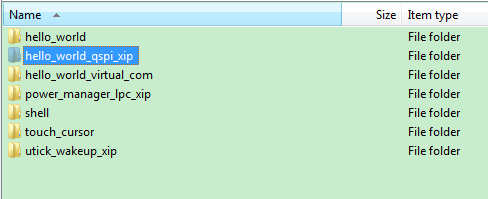

jeremyzhou
Hi Daniel Gull,
To provide the fastest possible support, I'd recommend you to run hello_world_qspi_xip for testing, this demo is an external flash XIP demo, CPU will execute the code in external flash.

danielgull
Hi Jeremy,
Thanks for the suggestion. I tried the application and could not flash, then I tried a spare Xpresso board and I can now flash the firmware. Seems like the board was defect.
Dani
