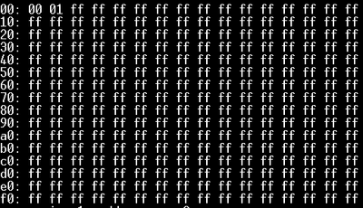

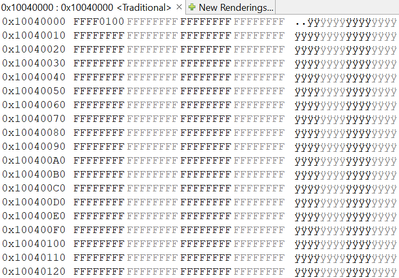

After these commands I can see the memory in the Memory window of MCUXpressoIDE (before it's just ????????), but only the first two bytes appear, the rest are 0xFFFFFFFF:
A memcpy() from the location shows the same, the first two bytes are read and the rest are 0xFF:
I've tried looking at other regions, such as where I'd expect the program to be, and see the same thing, a sea of 0xFF with the occasional pair of non-FF bytes.

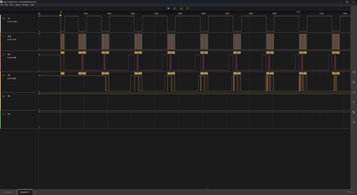

Quad mode write appears to work:
Read does something weird:

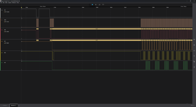

Output from logic analyzer. It appears the correct command is sent and then waits for the finish bit to clear.
