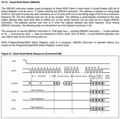

Yes, I'm using the Macronix MX25R6435F Flash part, since we are running at 1.8V
The spifi_dma_transfer example has an #if block that defines SPIFI commands depending on flash part, and I used the ones for FLASH_MX25R. Everything works except for the READ command. opcode 0x6B
Since the program works if I change the read to a fast SPI read (opcode 0x0B) instead of QSPI read, I'm assuming the command that is in the example is wrong, since you probably never tested with the MX25R parts.
I've attached the datasheet for the Flash. Can you look at Section 10-14 on page 40 and see if you can work out why the command fails?

andrewsglenn
Some progress: Quad mode read opcode 0x6B is not working, but I got it to work in fast read, opcode 0x0B:
static const spifi_command_t command[] = {
    [QREAD] = {FLASH_PAGE_SIZE, false, kSPIFI_DataInput, 1, kSPIFI_CommandDataQuad, kSPIFI_CommandOpcodeAddrThreeBytes, 0x6B},
	[FAST_READ] = {FLASH_PAGE_SIZE, false, kSPIFI_DataInput, 1, kSPIFI_CommandAllSerial, kSPIFI_CommandOpcodeAddrThreeBytes, 0x0B},
    [PROGRAM_PAGE] = {FLASH_PAGE_SIZE, false, kSPIFI_DataOutput, 0, kSPIFI_CommandOpcodeSerial, kSPIFI_CommandOpcodeAddrThreeBytes, 0x38},
    [GET_STATUS] = {1, false, kSPIFI_DataInput, 0, kSPIFI_CommandAllSerial, kSPIFI_CommandOpcodeOnly, 0x05},
    [ERASE_SECTOR] = {0, false, kSPIFI_DataOutput, 0, kSPIFI_CommandAllSerial, kSPIFI_CommandOpcodeAddrThreeBytes, 0x20},
    [WRITE_ENABLE] = {0, false, kSPIFI_DataOutput, 0, kSPIFI_CommandAllSerial, kSPIFI_CommandOpcodeOnly, 0x06},
    [WRITE_DISABLE] = {0, false, kSPIFI_DataOutput, 0, kSPIFI_CommandAllSerial, kSPIFI_CommandOpcodeOnly, 0x04},
    [WRITE_REGISTER] = {1, false, kSPIFI_DataOutput, 0, kSPIFI_CommandAllSerial, kSPIFI_CommandOpcodeOnly, 0x01}
Looking at the data sheet I think the command is correct for QREAD, but if anyone can spot the problem I'd be very grateful. I got the values from the sample code provided with the SDK.
