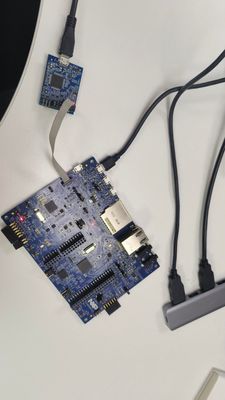

Hello @Beggar
I use MCU-LINK tested on my side, there is no issue.
Alice
9,921 Views
Beggar
Hello Alice,
Can you please send your MCU-Link debugger configuration/settings.
9,898 Views
Hello @Beggar
Attachment is hardware connection and debug steps video.
Alice

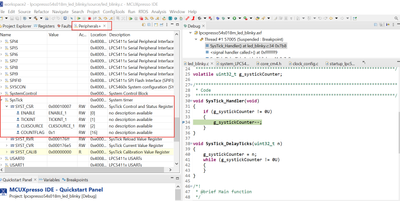

Hello @Beggar
1) You can check Systick register in "Peripherals+" view as below:
2) I have no board for this chip, so only can test on LPC54018. How about create a simple new project based on LPC54005, then copy application code from blinky  demo to your project, then debug check registers. If still can't work, send your project to me.
3) BTW, without Systick , does your board can work well? For example,  just turn on one led of your board.
Alice

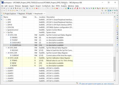

However, my Peripherals+ window is empty !?
10,167 Views
Hello @Beggar
1) However, my Peripherals+ window is empty !?
When debug, there is value in  Peripherals+ window . Please take a screenshot show yours.
2) Share your project, a simple project that can reproduce your issue, please.
Alice

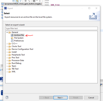

How do I share the project with you ?
10,138 Views
frank_m
Senior Contributor III
I would say, export it as archive from LPCXpresso.
Right-click you project in the workspace/projec window, and select "Export...".
Follow through, and attach the Zip archive to a post.
