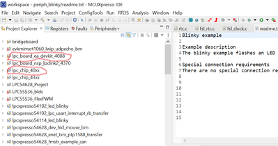

As the following screenshot, after you download lpcopen package from website, pls load the lpc_board_* project and compile it. Secondly, load the lpc_chip_* project and compile it, at the time, all the driver is okay. thirdly, you can load peripheral for example peripheral_blinky example, the project can be compiled successfully.
Hope it can help you
