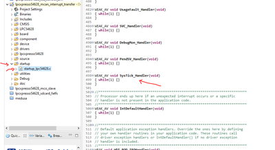

The first one is the handler location (in the vector table), and second one is the actual handler routine.
The location "./startup/startup_lpc54005.o" refers to a file in your project, see here (example from a project of mine):
This is the handler routine taking effect.
Do you see your code there ?

The WEAK SysTick_Handler exists in startup_lpc54005.c
However, when I set a breakpoint inside the WEAK SysTickHandler, it is never reached.

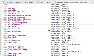

As a test, I added a Systick handler to one of my LPCXpresso projects that did not use Systick.
As seen here, the map file lists both instances, and the non-"WEAK" implementation first.
As implied, it is the file ./source/mcan_interrupt_transfer.c that implements the handler function.

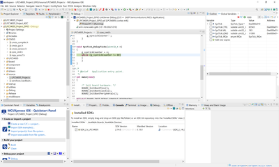

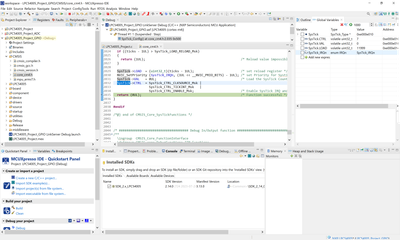

The SysTick_Config() function is visited and it seems that the register is set correctly.
But shortly after that it gets stucked in the while loop that waits for the counter to be zero.
I'm completely new to this IDE and debugging so forgive me if I ask silly questions.
And please let me know whether you can read the screenshots. Should I upload them as attachments ?
How can I verify that the Flag is really set ?
It seems that the SysTick_CTRL_CLKSOURCE_Msk is reset after the initial configuration. Is that a problem ?
Thanks for your help
2,695件の閲覧回数
frank_m
Senior Contributor III
Did you try to step into the SysTick_Config() function in the debugger , and see if the interrupt gets enabled (the IE flag set) ?
This function is usually implemented as "static inline" in core_cm4.h.
