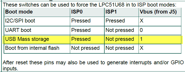

Currently, I'm customizing my own board with LPC51U68 micro and I do have some questions regarding bootload through USB.
1- Is it possible to boot a binary firmware file to the flash using USB or should I use JTAG pins through an OM40005 board? I've seen the documentation regarding ISP modes (3.2 PIN description of LPC51U68 User manual) but I'm pretty confused.
2-If I need a developer board will I need mandatory an OM40005 or can I use an OM13058 for instance?
3-I've connected directly LPC51U68 USB pins to USB connector and when I reset the LPC51U68 my PC finds CRP DISABLD disk (see attached image) but when I replace the firmware.bin to another binary file and reset LPC51U68, it finds the same previous firmware.bin file (manufacturer firmware). What am I doing wrong?

1.
You can use USB Mass storage boot mode with below settings.
2. To develop LPC51U68, please use board OM40005 LPCXpresso51U68
3. in USB Mass storage boot mode, remove old firmware.bin file. then drag and drop the new application firmware.bin to the CRP DISABLD disk. reset board to normal working mode, you should be able to see the application works. if go into USB Mass storage boot mode again. I verified the firmware.bin is not the same one as previous file.

So using USB Mass storage boot mode I can boot firmware to my LPC51U68 without OM40005 LPCXpresso51U68. i.e- connect USB to PC and to LPC51U68. Is that correct?

Yes, we USB Mass storage boot mode we can boot firmware with LPC51U68 USB port.
