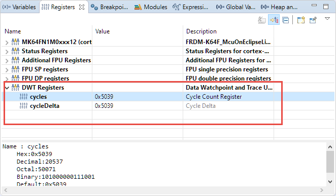

You could quickly try it with the NXP MCUXpresso IDE as it has a view to show the counter, see Measuring ARM Cortex-M CPU Cycles Spent with the MCUXpresso Eclipse Registers View | MCU on Eclipse
In version 11 (see New NXP MCUXpresso Eclipse IDE v11.0 | MCU on Eclipse ) it looks like this:

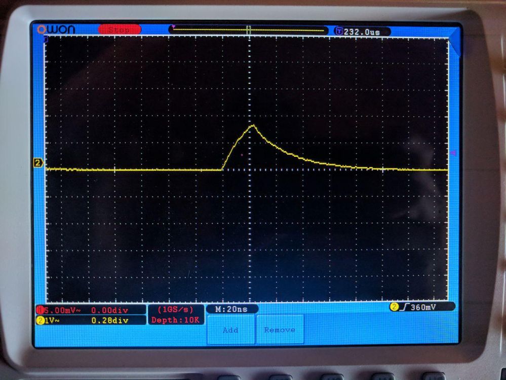

So, If I run It for a while what I get is:
max = 2450 (~12us if running at 204 MHz)
min = 22 (~100ns if running at 204 MHz).

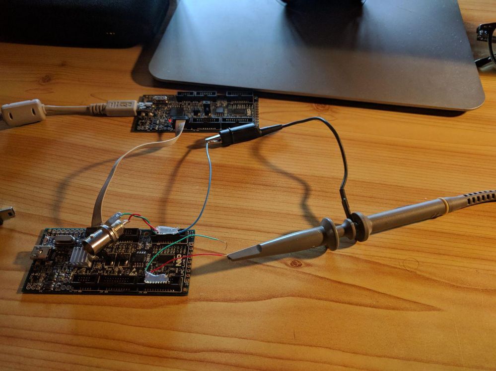

Here's also a pic of my scope and my setup:
I noticed that this 2450 value happens just at the very beginning and then no more.
Do you have a hint about why I don't get consistent measurements?
Best,
Andrea
