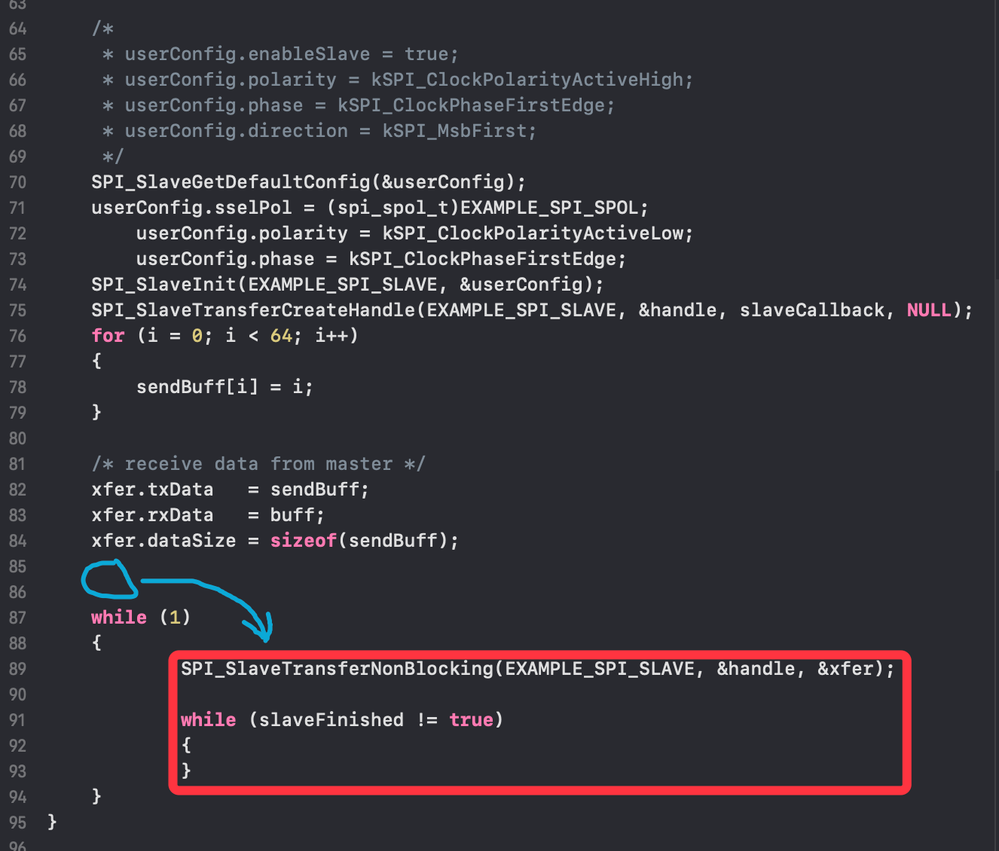

1.Modified LPC1114 example SSPMaster, sends 64 Bytes per frame and 82ms idle between 2 frames(in a while loop).
2.Modified LPC51U68 NXP example spi_polling_b2b_transfer_slave ,64 Bytes per frame, and data starts from 0x00, 0x01 till 0x3F. I also put transfer statements into while loop.( following screen capture shows what I have changed from the original file)
3.Connect LPC1114 Pin 0.6 to LPC51U68 P0.11, and conn P0.4 on LPC51U68 to GND and power up both boards then captures transfer with Saleae.
51U68 slave data always shifts header byte(1 or 2 bytes) from the second transfer in while loop.(Only 3rd frame corrects one time)
How can I fix this make SPI slave always starts from 0x0 and ends with 0x3F? Thanks a lot!

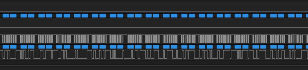

  1. For DMA SPI slave, I have to transmit about 8k bytes in a high clock rate(12Mhz) and almost without breaks(less than 0.3 us, as shown below) between every 2 bytes. It requires very fast respond in case of missing any data. So I think "link to next descriptor" would be a nice solution. Please help.
  2. Both SPI poll mode and DMA mode, the master device not came from me, I just have to adapt to it. It does not have CS signal, but I could use other GPIO pin as a trigger to pull the CS at the end of frame (not between bytes). Does this helps?
Thank you!
