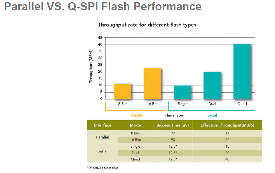

HI
SPIFI is high speed interface comparing other flash interface such as high-cost parallel norflash. But the code is executed from external memory which speed is slower than on chip memory, It's normal. SPIFI flash is not designed for peak code-operation speed, but if the part of code don't care about the speed so much. SPIFI is a good choice.

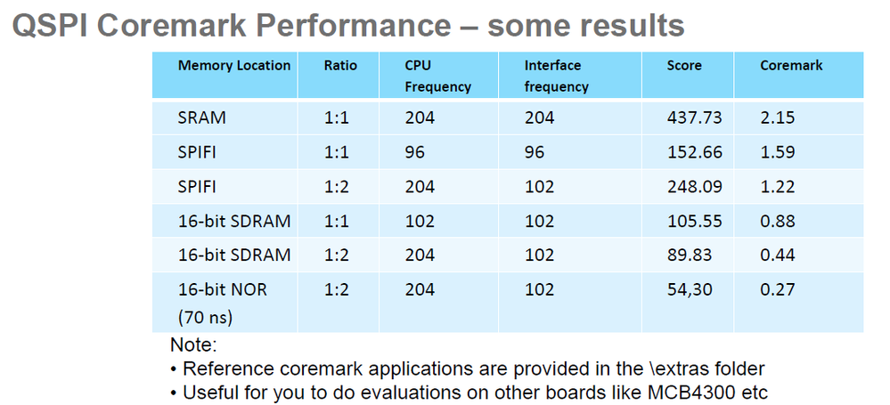

Here is some testing result of SPIFI, FYI

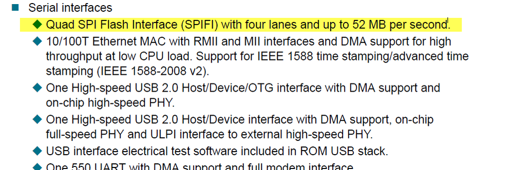

Can we use a faster SPIFI chip and increase the speed of the SPI interface LPC4370 (for example, up to 102 MHz)?
And could you explain the meaning of the Score and Coremark parameters in your table?

Hi Vitaliy Livnov,
I don't think SPIFI can get to speed of 102M/s.
according to the latest LPC4370 datasheet, the maximal speed is 52MB/s:
Regarding to "Score and Coremark", this information is extracted from my old backup. The original author is no longer here. I don't know how they tested it.
We can understand higher "Score and Coremark"  marks means higher SPIFI performance.
