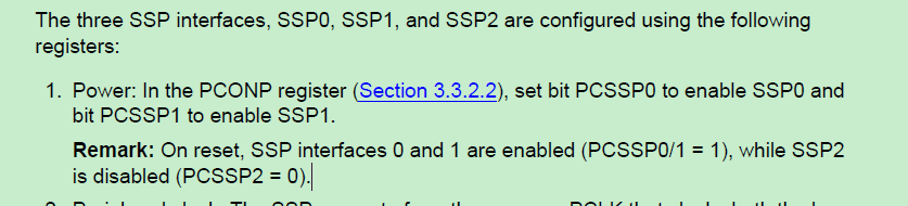

Hi everybody,
I'm using lpc4078 with LPCXpresso v8.1.4 (build 606).
I'm trying to configure SSP2 but when I write the Control Register 1 of SSP2 , LPCXpresso shows a fault.
LPCXpresso also doesn't show the SSP2 registers on the debug monitor.
Please note that with SSP0 and SSP1 everything works fine.
Do you have some hints about this issue?
Thanks in advance.
Alberto Ferrari

kerryzhou
Hi Alberto Ferrari,
   Did you enable the SSP2 interface  power/clock in register PCONP register?
From the user manual, you can get:
So, please check PCONP bit20, did you enable the SSP2 power and clock?
Kerry

albertoferrari
Hi Kerry Zhou,
I've double checked and it was my fault.
You were right.
I tryed to access to SSP2_CR1->SSE with the SSP not powered (PCONP->PCSSP2=0).
Thanks for your help.
Have a great day.
Alberto Ferrari
