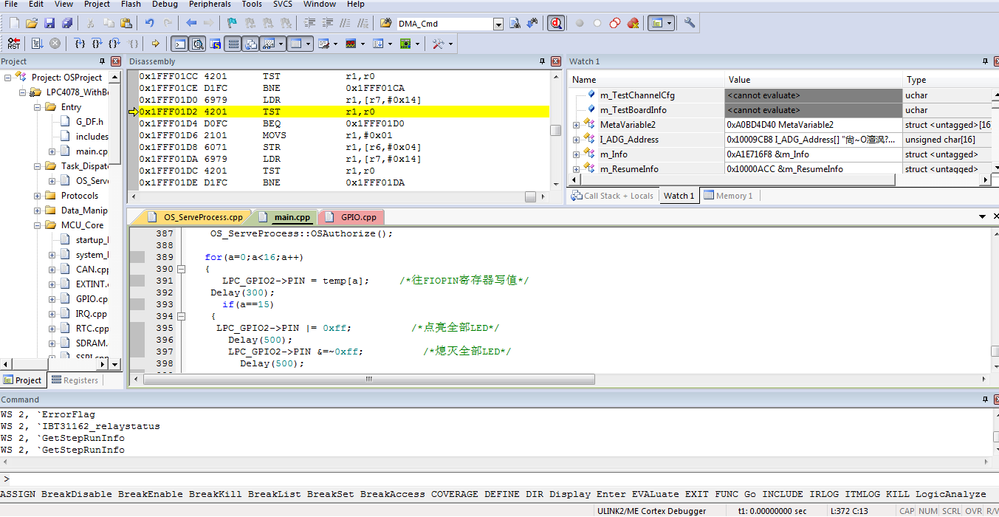

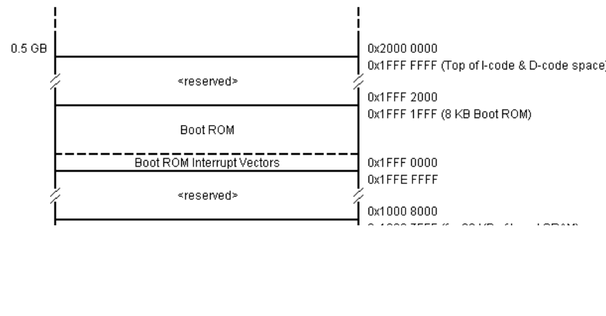

When under debug mode , use Keil v5,program is always run in "0x1FFF01S2  4201  TST    ri,r0"  ,and this is BootRom . My program could not jump to Main().
The CPU is continue resting ??

Before answering your question, I'd like to learn more information about this 'issue'. Whether you can clarify these below inquires.
1) Sharing the Option for Target in Keil.
2) Which board and demo you.
3) The voltage status of the ISP pin.
