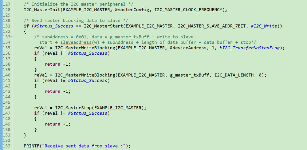

The block of code below is from i2c_polling_b2b_transfer_master.c.  Take a look at the usage of I2C_MasterWriteBlocking(); the two lines are marked with "<==HERE".  In the first instance, the address of uint8_t deviceAddress is passed.  In the second instance, the address of the data buffer to transmit is passed.  The compiler is told to expect a const void * so the compiler doesn't "squeak".

/* Send master blocking data to slave */
if (kStatus_Success == I2C_MasterStart(EXAMPLE_I2C_MASTER, I2C_MASTER_SLAVE_ADDR_7BIT, kI2C_Write))
   /* subAddress = 0x01, data = g_master_txBuff - write to slave.
       start + slaveaddress(w) + subAddress + length of data buffer + data buffer + stop*/
   reVal = I2C_MasterWriteBlocking(EXAMPLE_I2C_MASTER, &deviceAddress, 1, kI2C_TransferNoStopFlag);   <== HERE
   if (reVal != kStatus_Success)
   return -1;
   reVal = I2C_MasterWriteBlocking(EXAMPLE_I2C_MASTER, g_master_txBuff, I2C_DATA_LENGTH, 0);            <== HERE
       return -1;
   reVal = I2C_MasterStop(EXAMPLE_I2C_MASTER);

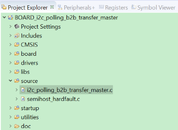

On the left side of MCUXpresso IDE see the "Create or Import a project".  Select "Import SDK example(s)..."
I have only one SDK installed, that for the 54628.  I left-click the image to select the board then left-click "Next".
There are a number of examples listed in the lower half-pane.  Open "driver_examples" and select "i2c".
The fifth example is "i2c_polling_b2b_transfer_master" and so I select that by setting the checkbox.  To avoid a project collision, I change the prefix to "BOARD_" (that's at top left).  Then click Finish.
The IDE runs... and I now have a project named "BOARD_i2c_polling_b2b_transfer_master".
Open the project then open the source folder.  There is "i2c_polling_b2b_transfer_master.c"
Open "i2c_polling_b2b_transfer_master.c" and scroll down to line 131.
First, what does this program do?  It sends a block of data, receives a block of data, compares the two, and hangs at the while-loop at line 200.
Okay.  Line 131 contains the call to I2C_MasterStart.().  Hm.  See below.
Lines 135 and 140 contain the calls to I2C_MasterWriteBlocking.  I believe Line 135 calls the wrong function... because deviceAddress contains the i2c address of the slave and &deviceAddress is the address of a memory location containing the slave's address.
But the documentation (you can see it via hovering the cursor) says that the second argument is a pointer to the data to be transferred.
Line 140 passes supplies the address of the buffer to be transmitted.  That's correct.
What is Line 131 doing?  Line 131 takes the I2C reference, something called "I2C_MASTER_SLAVE_ADDR_7BIT", and the last argument is kI2C_Write.  I2C_MASTER_SLAVE_ADDR_7BIT is a symbol with value 0x7EU.  I thought that address reserved.for future purpose.

I followed your posted steps and import the i2c_polling_b2b_transfer_master project.
I don't find there with any strange code at <i2c_polling_b2b_transfer_master.c> file:
The actual I2C master will transfer below signals:
line131: I2C master transfer start + slaveaddress(w)
line135: I2C master transfer subAddress
line140: I2C master transfer length of data buffer + data buffer + stop
Please check below I2C signal for the detailed info:
The MCUXpresso SDK server was maintained last week, I am not sure if that cause the problem code generated.
