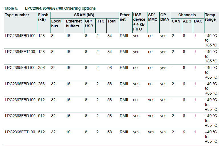

Hi.
Besides LPC2368 having 512kB flash and an SD/MMC support are there any other differences one must take care of? Would like to move from LPC2366 to LPC2368 without any bigger issues.

Yes, right. For details, see :

bernhardfink
With the LPC2368 you will get more flash, an SD-card interface and a USB port.
On top of this it's exactly the same architecture.
