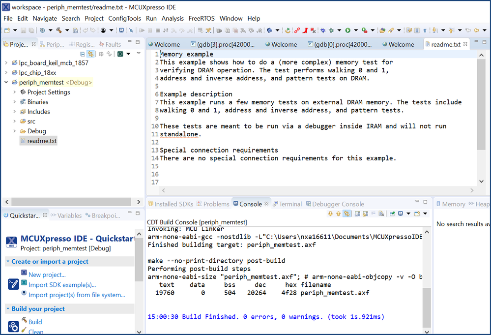

Can someone share a sample program for using the sdram on the keil mcb1800 board?
I am using MCU Xpresso IDE.

ZhangJennie
Shreyas Waichal,
In addition of Bernhard, we can use MCUXpresso IDE v11 open and build lpcopen_3_02_lpcxpresso_mcb1857 project without problem. ( I currently don't have this MCB1858 board, so I didn't test debug). see below.
LPCOpen demo "periph_memtest " is the memory example I recommend.

bernhardfink
There is no MCUXpresso SDK for the LPC1800/4300.
Please go to this page and select the right package for your MCB1800 platform:
LPCOpen Software for LPC18XX | NXP
I'm not perfectly sure, but I think the package for LPCXpresso v8.2.0 can be imported into a MCUXpresso environment.
There should be examples which set up the SDRAM on the KEIL board.
