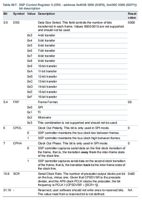

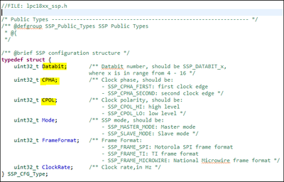

In the User manual CR0 is 4byte same as mentioned in @file LPC18xx.h.
However the SSP configuration structure in @file lpc18xx_ssp.h takes 12 bytes for the CR0 bit setting.
Please find the attached images for your reference.

Kushal_Panchal
Hi @daniel598lopez,
Please find the attached images again.
Let me know, if you need any other help.
Kushal
Kushal_Panchal_0-1736312481190.pngKushal_Panchal_1-1736312511069.pngKushal_Panchal_2-1736312529483.png

Harry_Zhang
Hi @Kushal_Panchal
I checked the LPCOPEN 1850.
I just find the LPC18XX.h, but i didn't not find the lpc18xxssp.h.
May I ask which LPCopen package this file is in?
Harry
8,086件の閲覧回数
Kushal_Panchal
8,036件の閲覧回数
Harry_Zhang
Hi @Kushal_Panchal
Sorry, this is not the code we officially maintain.
Harry
