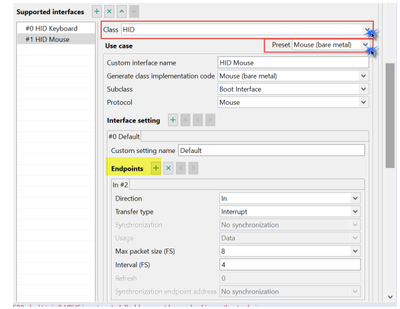

Hello @MHY_0878
If you are new to LPC55S69 USB, I suggest you use the Config Tool inside MCUXpresso IDE to configure the USB. It is also easy to add an OUT endpoint using it.
It is a graphical configuration interface. And it is friendly for beginners in development,  There is a quick - start guide that you can refer to:
https://community.nxp.com/t5/LPC-Microcontrollers-Knowledge/Using-ConfigTool-to-create-USB-Project-F...
