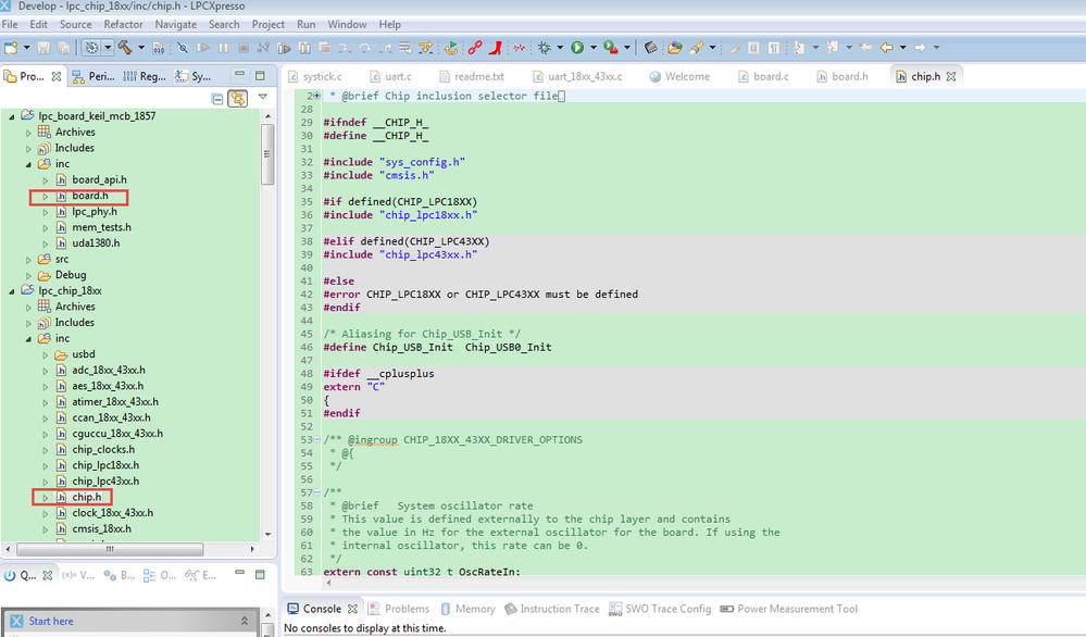

I seem to be missing the chip.h and board.h header files and unable to find them.
Is it possible you can advise me where to find them.

Hi Andrew Barningham,
     You can find the chip.h in the lpc_chip_18xx lib, board.h in lpc_board_keil_mcb_1857 lib.
     Take the lpcopen  lpcxpresso project as an example:
  When you add the project, you must add the lpc_board_keil_mcb_1857 and lpc_chip_18xx at first, then add your own project or other application project.
Wish it helps you!
Kerry
