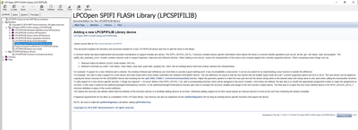

Hello Tony,
There is a guide about how to add new LPCspifi lib device in "spifilib_v1_101.chm" under spifilib folder,
You can try to refer to it add your device.
And about how to use Flash Magic to program external flash, I think it is hard, this tool is made by third part, and it just
illustrate some IC, doesn't give how to change to other flash chips.

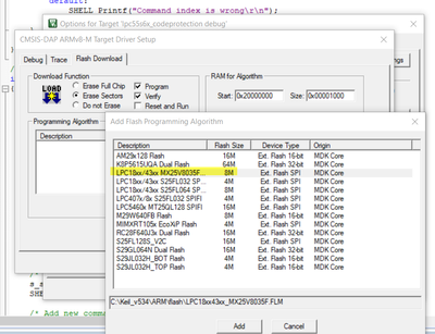

Hello Tony,
>The SPIFI LIB is old , and there is one update this.  It should be some change from 2012-2014, because
in 2014 there is new version v1.01:
https://www.nxp.com/products/processors-and-microcontrollers/arm-microcontrollers/general-purpose-mc...
> KEil can program external flash, there is some programming Algorithm, you can try.
I think it should be work with MX25V1606F, while not AT25SF161B.  In the SPIFI device support table,  there is no ATxxxx:  https://www.nxp.com/products/processors-and-microcontrollers/arm-microcontrollers/general-purpose-mc...
If the programming Algorithm doesn't work, tell me.
