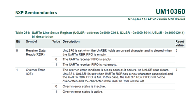

Hello everyone, I'm trying to read temperature and store and send back the data I send. I can do that without any problem using cp2102 USB to TTL module, however when I replace cp2102 module with HC05 bluetooh module when I enter the data instead of the data (two digit number) I enter, I recieve a very long and irrelevant number like 65121. I attached my code. By the way my ARM is LPC1768
Thanks in advance,
Alex

xiangjun_rong
Hearing You have not solved your problem, I am sorry.
Regarding the code:
void UART_IntReceive(void)
data[Index]=UART_ReceiveByte(LPC_UART3);
Index++;
if (Index>=N)
Index=0;
//UART_SendByte(LPC_UART3,data);
As you know that all interrupt sources of usart module share the same interrupt vector, I suppose that you have to check the interrupt source before you read the receiver data.
if(LPC_UART3->LSR) & 0x01)
Index++;
if (Index>=N)
Index=0;
If the line LPC_UART3->LSR) & 0x01 has compiling error, pls modify it based on your architecture to access peripheral register.
Hope it can help you
XiangJun Rong

@xiangjun_rong Hi, thank you very much for your time and reply. Yeah, I thought I solved my problem last time then I realized that I didn't. I tried what you recommended, but it didn't help. I checked my debugger again and realized that whatever I type always data[0] is 13 and data[1] is 10, and because I tried to change the data from ASCII to int I subtracted '0'( when I had cp2102 I had to do this because for some reasons the numbers where in ASCII). That's why I get that large number like 61548. So, if I don't subtract '0' I have 13 and 10 and definitely 13*10+10 will be 140. They don't change when I type something else. I uploaded the screenshot of the debugger. Someone else said that it might be because of the baudrate, but I doubt that because I have no problem sending data. I only have problem in receiving data. Plus, I understood that the program works fine when I step over in debug mode exactly like cp2102, however when I run the program I can clearly see that only 13 and 10 get saved regardless of what I type, but when I step over in debug mode and the program works slowly it can successfully save my data. btw I tried to change the baudrate, but it didn't help either.

xiangjun_rong
Hi, Alex,
I have checked your code, I do not understand your code clearly. This is my suggestion.
1)pls narrow down  your problem, whether you have problem when you receive character or you have issue when you deal with the received characters.
I suggest you receive a string for example 100 character and check if the characters are correct or not, if there is missing characters. If you receive characters well, it is your job to deal with the received characters.
Pls #define N 100, then check the data array if the received characters are correct or not.
2)For the while loop, you should update the flag so that you handle the data only once.
if(flag)
data4=(data[0]-'0')*10+(data[1]-'0');
flag=false;
Secondly, it appears that your received data is digital number rather than ascii code, I do not know why you subtracts "0".
Have a nice festival.
Xiangjun Rong
while(1)
uint16_t data4;
if(flag)
if(data[0]!=0&&Index==1)
data4=data[0]-'0';
Index=0;
data[0]=0;
data[1]=0;
if(data[0]==NULL&&data[1]==NULL)
data4=0;
// float temp1=HW_ADC_Read(1)/10.0F;
float temp2=20.0F;
uint8_t len=sprintf((char*)buffStr,"%f\n %u\n",temp2,data4);
UART_Send(LPC_UART3,buffStr,len,BLOCKING);
if(temp2>data4)
GPIO_SetValue(2,(1<<5));
else if ( temp2<=data4)
GPIO_ClearValue(2,(1<<5)) ;
Delay_RIT_ms(1000);
