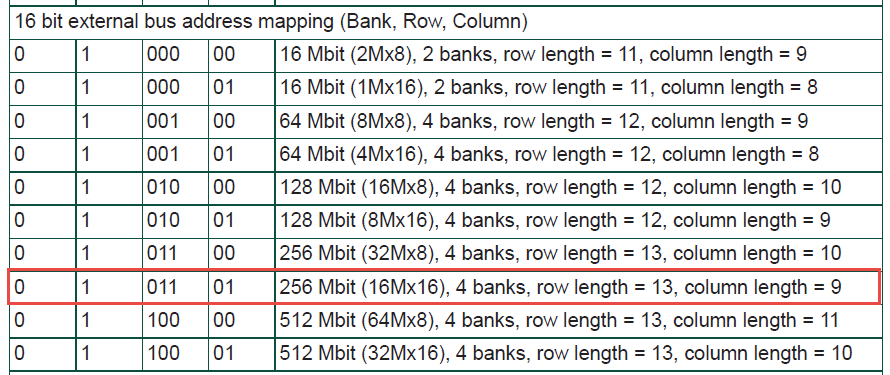

I'm using an external SDRAM connected to the LPC1788FDB208 microcontroller. As SDRAM I chose (and unfortunately already bought many pieces) the IS42S32160F-7TLI model ( http://www.issi.com/WW/pdf/42-45R-S-32160F.pdf  ). This model is a 512Mbit SDRAM structured as 4Mx32x4 (4 Meg x 32 bits x 4 banks). Reading the LPC17xx user manual I seem to understand that the LPC17_xx family doesn't support the 512Mbit SDRAM structured as 4M x 32 x 4 banks, is this correct? Did I well understand? If yes (the LPC17_xx family doesn't support the 4M x 32 x 4 banks configuration) is it possible to use my 512 Mbit SDRAM as a 256 Mbit? If yes, how do I have to configure the DINAMICCONFIG0 register?

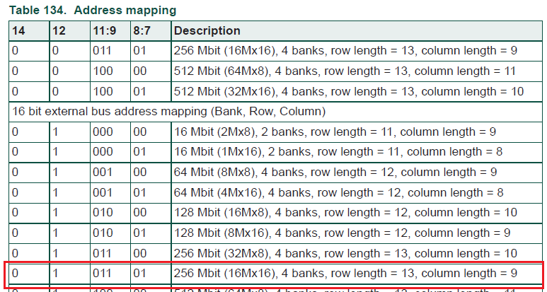

Sorry, but I don't understand what setting I have to choose. The table 134 of the attached file shows the possible configuration, can you tell me what I have to choose? From the hardware point of view, is there any modify to do?

1) The table 134 of the attached file shows the possible configuration, can you tell me what I have to choose?
-- Please check the Fig 1.

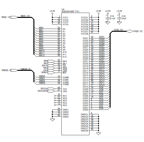

2) From the hardware point of view, is there any modifications to do?
-- No, just like you connect a 32-bit SDRAM(as the Fig2 shows).
Fig 2

Below the new SDRAM connections
Attached you can find my SDRAM configuration and test code
Many thanks

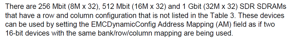

jeremyzhou
Thanks for your reply.
1. It seems a bit weird that the SDRAM would work well after setting the addressing map as the Fig1 illustrates, it is definitely inconsistent with its datasheet. So I have no idea now.
Fig 1
2. I've attached an SDRAM demo, please use it as the template demo code and run it for testing.
TIC

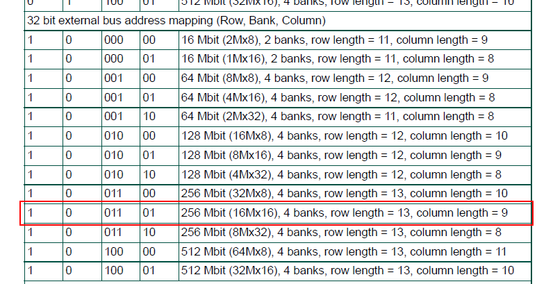

Your previous suggestion was
I am a little bit confuse.. Smiley Happy. Can you explain me?
Many thanks
12,648 Views
jeremyzhou
Hi Nico Aprile,
According to the below statement (Fig 1), the Fig 2 is correct, so I made a mistake before.
Hope this is clear.
Fig 1
Fig 2
TIC

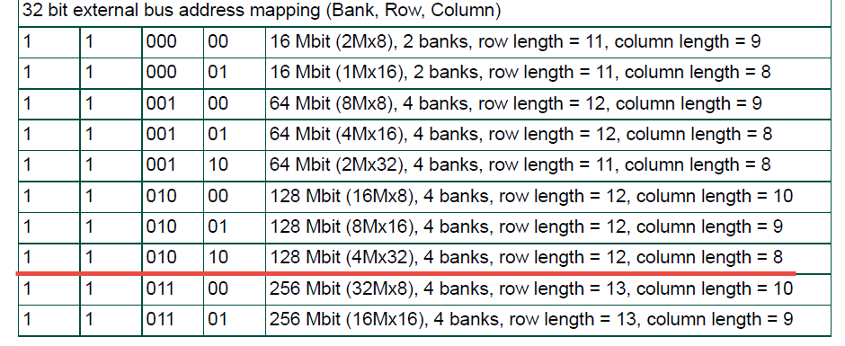

aut
Hi jeremyzhou,
many, many thanks!
Your indication is:
Why not the following?:
In other words, what's the bit 12 function
Have a nice day.
12,648 Views
jeremyzhou
Hi Nico Aprile,
Actually, both are available.
However, It's the 16-bit external bus high-performance address mapping when the bit 12 is 0.
TIC
