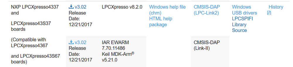

Hi everybody, I have got an PLC43s37 and I'm looking for a way to configure an analog pin on the board to read a value from a sensor, temperature for example?
2,824 Views
Hello luca bonora,
You can download and refer to the LPCopen , there is periph_adc demo:
LPCOpen Software for LPC43XX | NXP
Hope it helps,
TIC
