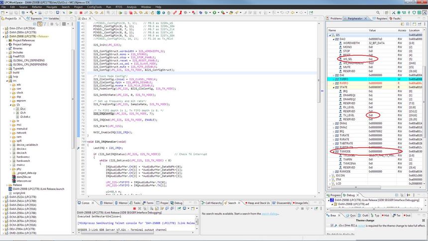

we are using the LPC1778 controller series for some years with I2S port in master mode and everything works fine.
Due to a necessary change in our DSP, it is necessary to switch the I2S port of LPC1778 from master mode to slave mode. Unfortunately this does not work! There is no data sent on the I2S port and there is no interrupt or DMA-request!
We have made some investigations and it seems that the external I2S_TX_CLK is not connected to the I2S peripheral block.
We feed in the TX-CLK at the pin I2S_TX_CLK and set the I2SDAO[5] to 1 which switches the multiplexer to the external I2S_TX_CLK input. According to the block diagram it should be possible to see the clock at the I2S_TX_MCLK pin if I set the I2STXMODE[3] to 1. But nothing comes out of the pin. If we set the I2SDAO[5] to 0 and setup the fractional divider, we can see the clock frequency at the pin I2S_TX_MCLK.
Is there any special setup necessary to switch to I2S slave mode?
Thank you for any hints!

FriedrichWaas
Hello Raul,
thank you for your hints.
We have doublechecked our setup with the setup like you described and it is the same.
Here are the screenshot of the settings:
At startup I get an IRQ until the fifo is full.
Clocks on SCK and WS from external peripherals are available.
But: No data output is measurable.
Did we forget some settings or is there a error in the CPU?
Best regards, Friedrich Waas

RaRo
Hello @FriedrichWaas,
In the LPC178x/7x User manual: Chapter 23. LPC178x/7x I2S Interface. Section 7. I2S operating modes. You may find useful information related with the I2S operation in slave and master modes; in I2S transmit mode, there are conditions to make the I2S to work as slave: I2SDAO[5] it is set to 1 and I2STXMODE[3:0] needs to configure with 0000 for a typical transmitter slave mode, with 0010 for a sharing receive reference clock transmitter slave, or with 0100 for a 4-wire transmitter slave sharing the receiver bit clock and WS.
Note: Configuring the I2S as typical slave transmitter, the clock source is TX_CLK pin as input.
Also, please check the registers for configuring correctly the slave mode for I2S, especially DAO and DAI.
Best regards, Raul.
