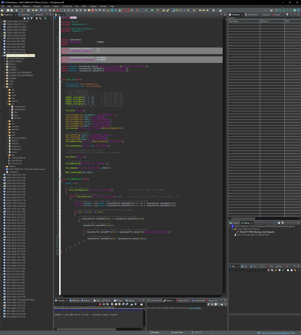

FriedrichWaas
Thanks for your reply.
I tryed to change the order of irq init but it doesnt matter. After enabling the i2s-irq the irq-handler will be called once and the loop will fill the tx-fifo until the fifo is full. No data will be sent and the fifo will stay at the filled level.
As attachment nessesarry files for you to chek it.
Thank you very much! 
Best regards, Friedrich Waas

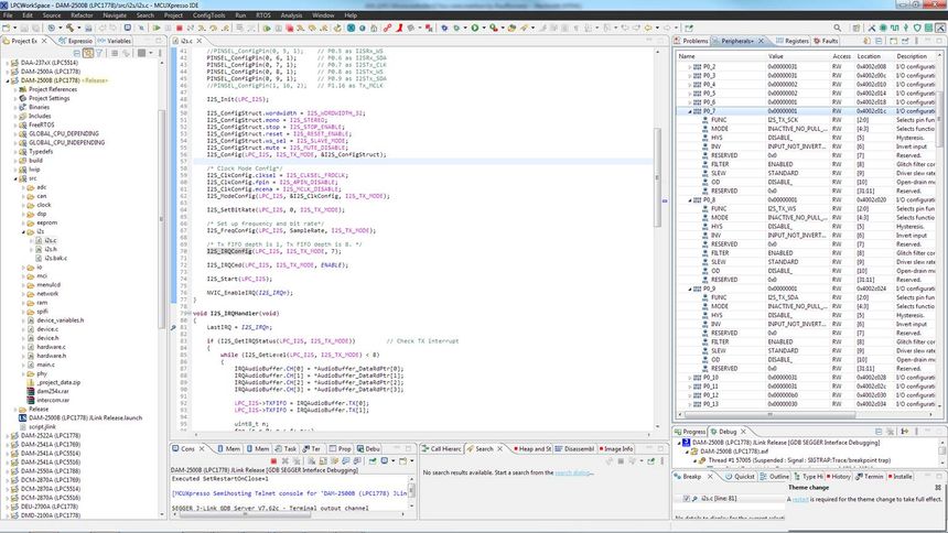

FriedrichWaas
Hello Raul,
thank you for your hints.
We have doublechecked our setup with the setup like you described and it is the same.
Here are the screenshot of the settings:
At startup I get an IRQ until the fifo is full.
Clocks on SCK and WS from external peripherals are available.
But: No data output is measurable.
Did we forget some settings or is there a error in the CPU?
Thank you for any hints!

RaRo
Hello @FriedrichWaas,
Could you please share your I2S_IRQHandler() code? Just for double check, are you sending a 32-bit data to TXFIFO for transmition, trough I2S_Send() or similar name?
It seems your slave configuration is correct, so it might be good to review the FIFO transmition. Nevertheless, could you please change the order of lines I2S_IRQConfig() and I2S_IRQCmd() after I2S_Start()?
Best regards, Raul.
