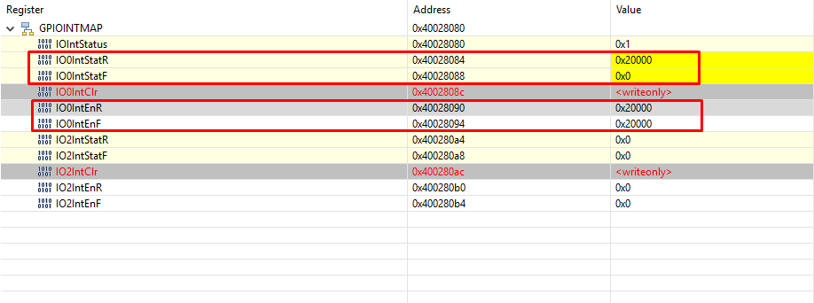

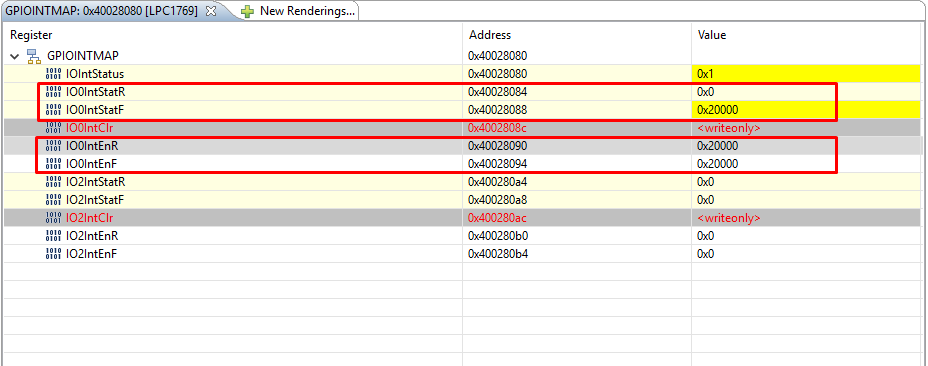

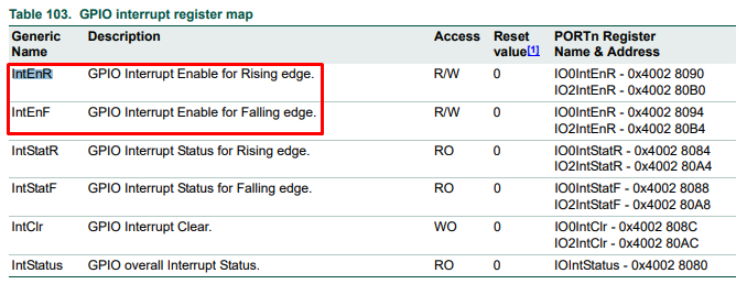

victorjimenez
Hello Daniel,
If you reference the user manual (UM10360.pdf) chapter 9 table 103. You will see that ENR and ENF represents if  the GPIO Interrupt is enable for Rising and Falling edge respectively.
So, since you want to trigger the interrupt on both rising edge and a falling edge the values of ENR and ENF will always be 1. The values you need to look to know which interrupt was triggered are STATR and STATF, since these values represent the status for either rising edge and falling edge interrupt.
I made an example using the same characteristics that you mentioned, so you can see how the registers work. In the next image you can see that the values of ENR and ENF are static in 1 since I activate the interrupt in both edges. But, the value  of STATF changed to 1 because the falling edge interrupt was triggered, STATR reminds low.
In the next interrupt you can see that the values of ENR and ENF are still the same. However,  this time the STATF is 0 and STATR is 1 since now you detected a rising edge interrupt.
So, in your interrupt handler you should check these values. Here is the handler I declared for the example I made.
