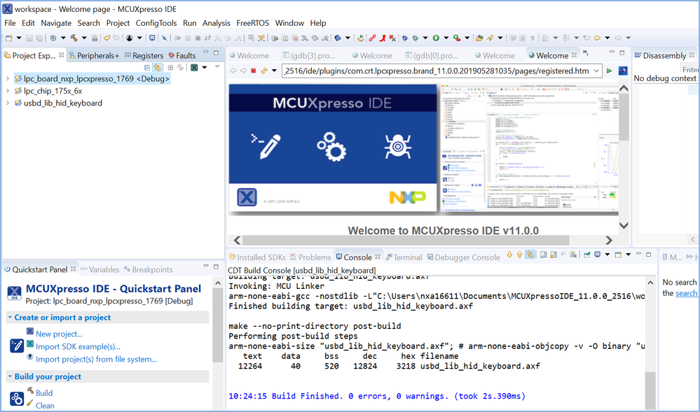

ZhangJennie
HI Alican Çeviker
Please make sure you build the related libs prior to the usbd_lib_hid_keyboard.
I just test build from my side, it can pass build without any issue. see below:
