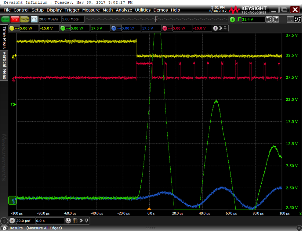

I am using the LPC1768 in an application where a few DC motors are controlled using PWM signals. I am using the PWM peripheral in single edge mode on four of the PWM outputs, the frequency is 93.75 kHz (24 MHz PCLK, 8 bit PWM).
The motor speeds are updated every 12.5 ms for generating the required speed profiles. Basically, it all works very well.

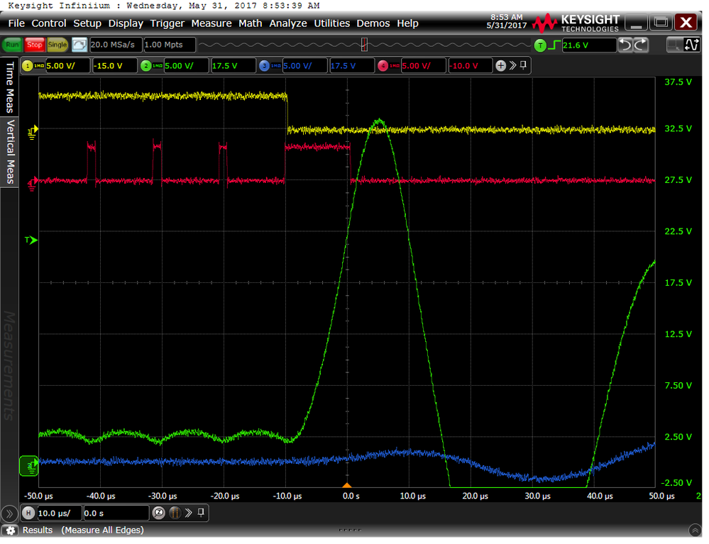

However, every now and then the PWM outputs a static high signal for one PWM cycle (that leads to a small spike at the motor) or even a complete 12.5 ms update cycle (which causes a hard beat from the drive). The time between such failures varies between several tens of seconds and several tens of minutes (with constantly moving motor), so it's hard to trace... I am observing this only with one of the outputs (PWM1.2), however that may be caused by the fact that this motor is moving most of the time and the others only rarely. As far as I can tell, the failure happens only after the previous PWM output has been constanly low (match register is 0), and it appears to be depending on the exact time (regarding to the PWM timer) when the match register and LER bits are written (see at the last screenshot far below).
I am attaching a few screenshots.The yellow trace is a port toggling with every writing to MR2 and LER, the red trace is the PWM1.2 signal. Green and blue are motor voltages and not too useful at these timescales - I used them as trigger.
The following screen shows a single PWM cycle failure. The match value is being changed from 0 to 32. It can be seen that after the MR2/LER update, the PWM output stays high for one PWM cycle, then reverts to normal PWM operation with 32/256 duty cycle:
Here is an "update cycle" failure. The situation is the same, MR2 is changed from 0 to 32 - but this time, the PWM1.2 output stays high until MR2 is updated again 12.5 ms later (you can imagine that this causes a hard and loud bang from the drive):
After the next update, the PWM output again stays high for one single PWM cycle before reverting to the correct duty cycle. This screenshot is just a zoomed part of the previous one, at the next update (12.5 ms):
For comparison, here is a screenshot of a normal, correct PWM update:
Take care that the MR2/LER update occurs somewhere in the middle of the PWM timer cycle in this case. In the screenshots showing the two failure types (further above), it appears that the MR2/LER update is just hitting the internal PWM update process. Maybe that is causing these problems here. Of course these two timers/processes are asynchronous to each other, so this can happen at any time. Looking at the rather rare failure rate, it seems that the "critical time slot" for the update is rather small.

I was using ORing in PWMLER and facing very similar issue. The 4th channel got stuck until next write into MR4 was performed, not only one period.
The datasheet in addition says that user software should not write ones to reserved bits of PWMLER, and a value read from a
reserved bits of PWMLER is not defined. So doing a simple ORing may cause writing ones into reserved bits.
Finally it helped me to save the PWMLER into temp variable, clearing the PWMLER, update the MR registers as needed and restoring the PWMLER back as necessary. Something like this:
static inline void SetVertPWM(uint16_t x) {
uint32_t ler = PWMLER & 0x7F;
PWMLER = 0;
PWMMR2=(x<256)?x:255;
ler |=BIT(2);
PWMLER = ler;

ziemowitpodwyso
I'm observing simillar issue when relatching 2 PWMs signal one after another. When duty cycle of one of them is zero and new value is provided, first cycle is fully on. Only happens when transition from zero duty cycle. Definitely something wrong with silicon.
Z.

tilmannreh
Hello Marc,
first results after always setting LER to 0x1F: There has not been a hard bang for a really long time now. It appears that this really does not happen any more.
However, there's still something wrong with the PWM output. Now it rarely happens that when changing the match register from (say) 32 to zero, the output becomes high for a single PWM cycle:
Obviously there's a "weak point" when you shouldn't write to the MR and/or LER register(s), and this appears as a bug to me.
Tilmann

tilmannreh
Hello Marc,
thanks for your answer.
ORing bit 2 into PWMLER is fully on purpose. Unfortunately, you can also reset a pending LER bit by writing a 0 to it - and if the latch update has not yet been processed, it will never happen then. The other PWM channels are set by other processes, and when setting a single other bit there the LER bit of this process maybe reset, so the update is missed here (and vice versa). This also does not happen too often (the PWM cycle time is about 10 µs), but before I used ORing I had problems with missing PWM updates indeed. (This register appears misconstructed to me - it should rather behave like a "set only" register, similar to FIOxSET.)
Simply setting all LER bits for every update is worth a try. I'll report later.
However, from the reference manual, there should not be any side effects when reading PWMLER first. It also does not mention any critical moment for updating MR/LER.
